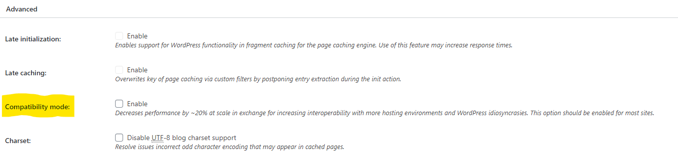

    Just to confirm, In Performance>Page Cache>Advanced section you are not seeing “Compatibility mode”?
    Can you please check this image and confirm that?

    This is very strange. “Maximum lifetime of cache objects:” should be located in Performance>Database cache.
    Here is the screenshot of the advanced sub-box of Performance>Page Cache (how it’s supposed to be).
    Can you please share a similar screenshot?

    Hmm…so I was denied 2 options… lol
    Here it is… PageCache Advance box
    Is it interference from another plugin?

    W3 Total Cache generates those rules only in compatibility mode.
    The compatibility mode option is shown only when disk-enhanced is used. What caching method are you using? Maybe Memcached or Redis? If you have had Disk: Enhanced enabled and then switched to something else there is a possibility that the Compatibility mode was selected and now affects browser cache rules historically.
    Two things that you can do potentially. You can switch back to Disk: Enhanced save all settings and then disable compatibility mode, save all settings and purge caches. The other thing that you can do is to manually remove W3TC rules from .htaccess and leave the .htaccess only with WP default rules. This will allow W3 Total Cache to write new set of rules to your .htaccess file.
