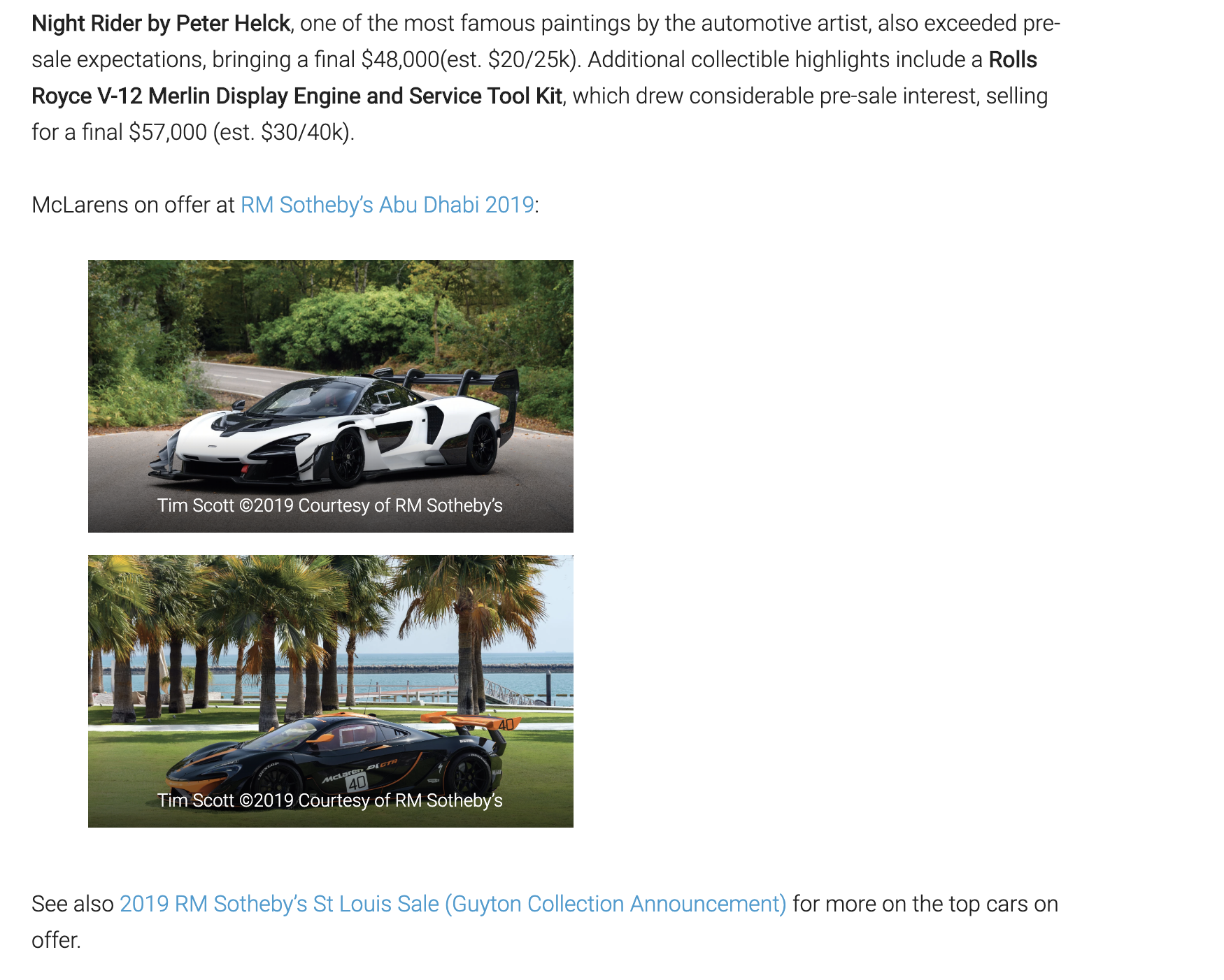

I made a sample page with two modern McLaren cars at the bottom of the post that should be next to each other rather than one below the other at:
https://www.classic-car-auctions.info/usa/2019-rm-sothebys-st-louis-sale-guyton-collection-auction-results/
At existing posts, the galleries still work as they should but if I try to edit the page it immediately places the photos one underneath the other rather than next to each other, eg. at https://www.classic-car-auctions.info/european/other/2019-rm-sothebys-abu-dhabi-sale-auction-preview/

That is what is supposed to look like (and what I get with the plugin off) but I don’t get the two photos next to each other in Chrome, Safari, Firefox or a clean install of Opera on macOS Mojave. The same for all those browsers on an iPhone.
The problem is immediately (but temporarily) solved if I deactivate the Litespeed Cache plugin.
As soon as the Litespeed Plugin is activated it is back to this: https://www.classic-car-auctions.info/wp-content/uploads/2019/11/Screen-Shot-2019-11-14-at-18.15.53.png
