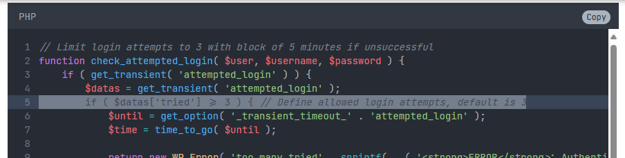

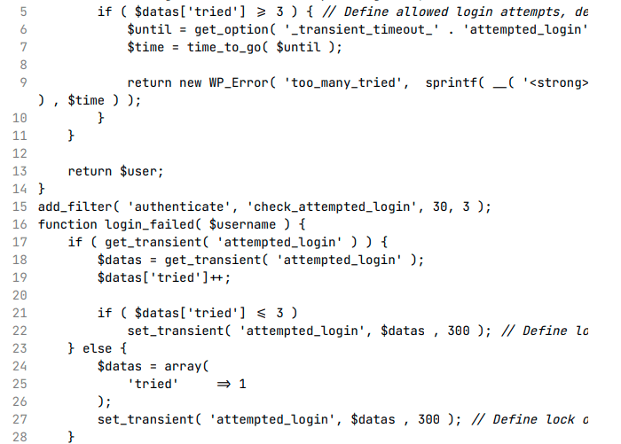

    Just tested with the new CSS you provided and it does wrap but not correctly. By this I mean it is cutting the edges of any commands that are longer than the edge but then trying to wrap other lines…
    Here is an image showing what I mean:
    Line 5 is clipped but it shows fully in the post:
    Lines 22 and 27 are longer than the container but are also clipped. Only thing that links these three lines (5,22, and 27) is that they are all highlighted.
    The only Line 9 that tried to wrap was line 9 but this isn’t highlighted so there is a visible pattern to the issue.

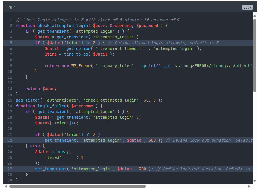

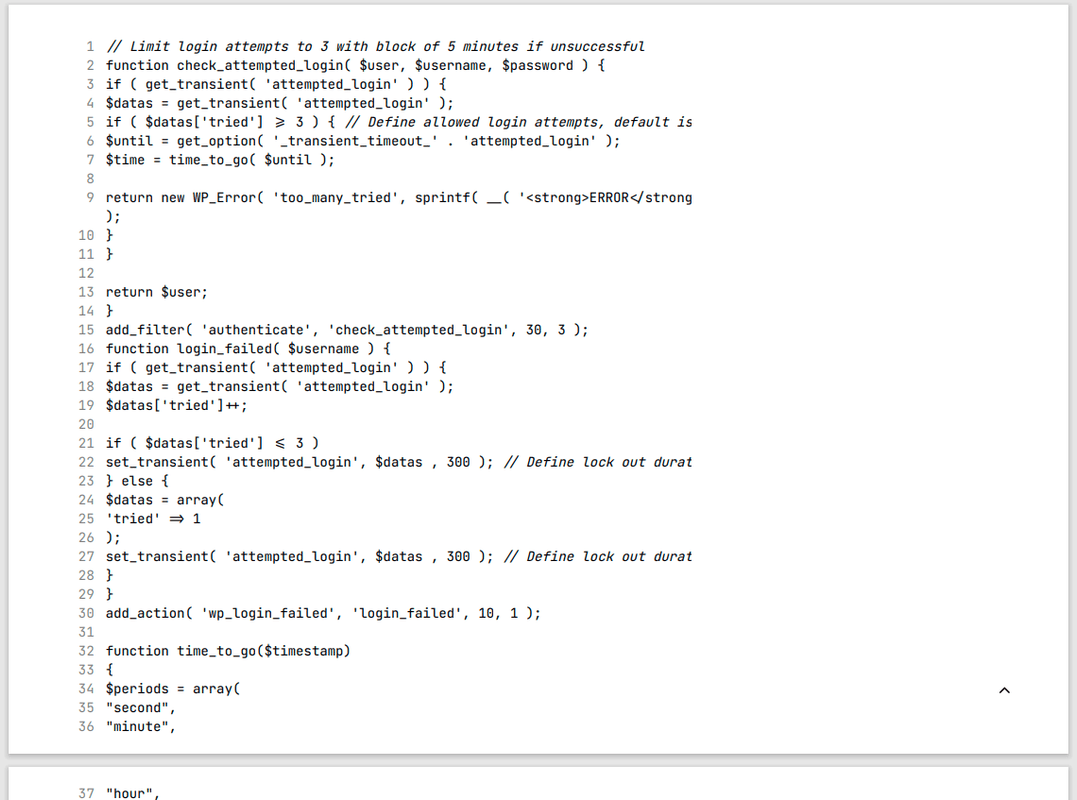

    Still cutting lines short, and now also removing formatting.
    This is what it is supposed to look like:
    This is what I get in print preview:

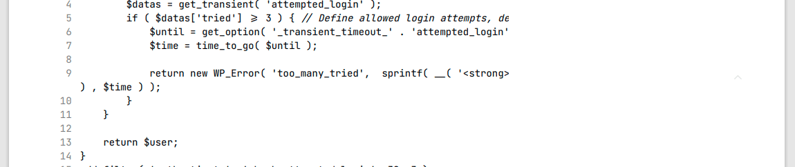

    With the CSS you suggested applied, it looks like this:
    Note that line 9 is not being correctly shown. You can also see other lines (5 in this example) also suffer the same issue.
