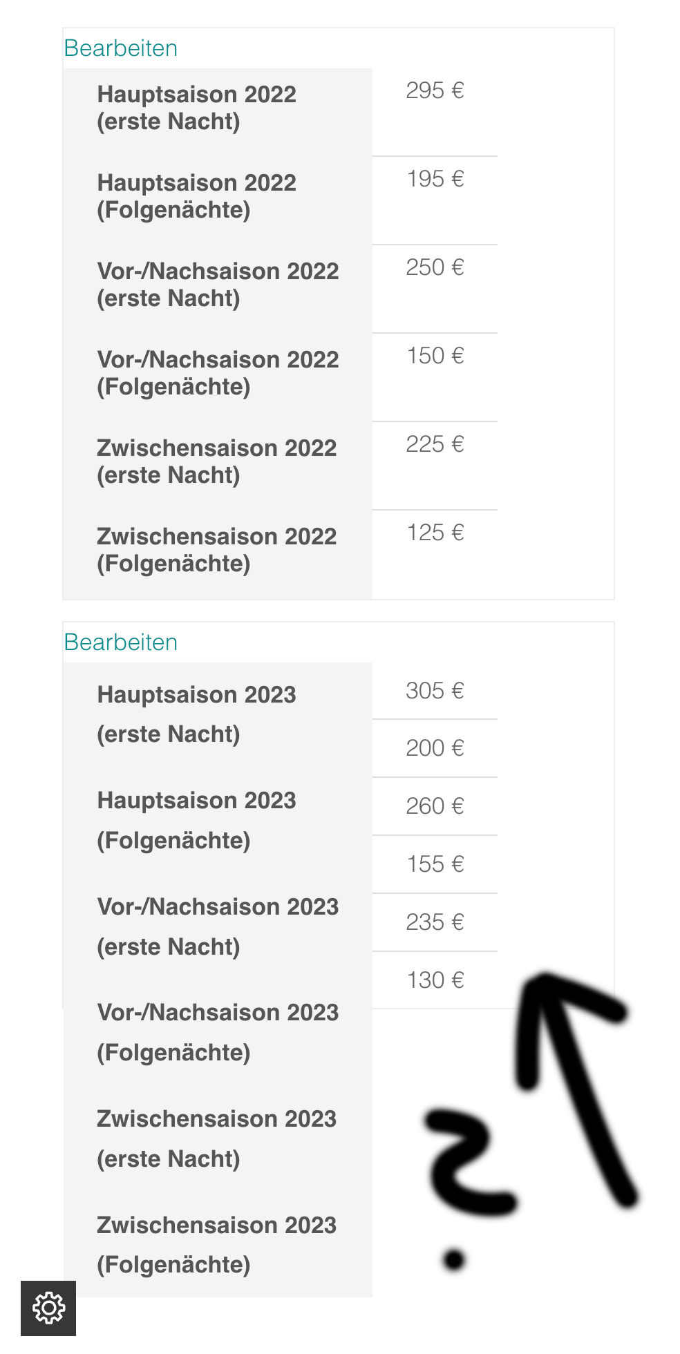

    Hallo, i have 2 Tables on my side with the responsive Mode “flip”. The first one looks good on Iphone, but in the second table, the prices have been shifted upwards like you can see in my Link and in this Picture here
    https://webdesigner-sylt.de/wp-content/uploads/2022/07/flip.jpg
    Do you have a solution for that? Thank you and greetings from Germany

    thanks for your post, and sorry for the trouble.
    This is essentially the same issue as in your support topic some years ago, see https://ww.wp.xz.cn/support/topic/problem-with-responsive-view/ .
    You will manually have to set the row height in the responsive view. For that, just add this to the “Custom CSS” textarea on the “Plugin Options” screen of TablePress:
    @media (max-width: 767px) {
    	.tablepress-id-17 th,
    	.tablepress-id-17 td {
    		height: 64px;
    		line-height: normal;
    in the same way as you have done for the other tables.
    Regards,
    Tobias

    Haha, i forgot that, thanks to Corona ^^
    Big thx
