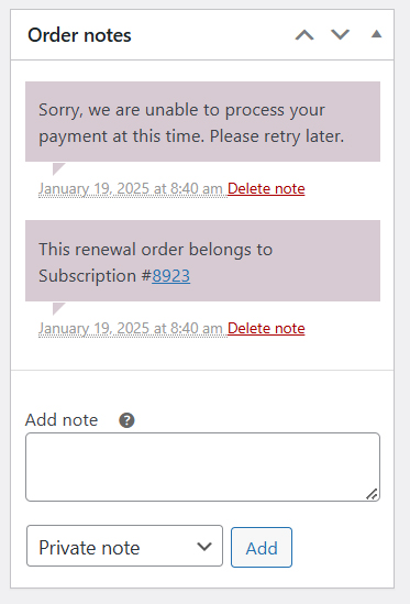

    Thread Starter twistedvmarket
    (@twistedvmarket)
    This is the message in the order notes section. Unfortunately, I do not have the ability to manually retry the payment processing later as it suggests (that I’m aware of.)
    Plugin Author WP Swings
    (@wpswings)
    Hello @twistedvmarket
    By checking order notes it seem like customer card token is not saved on their woocommerce account on which subscription renewal through stripe is not working
    If card token is not saved or if it is removed by customer followed by my account then renewal will not process
    Thank you
