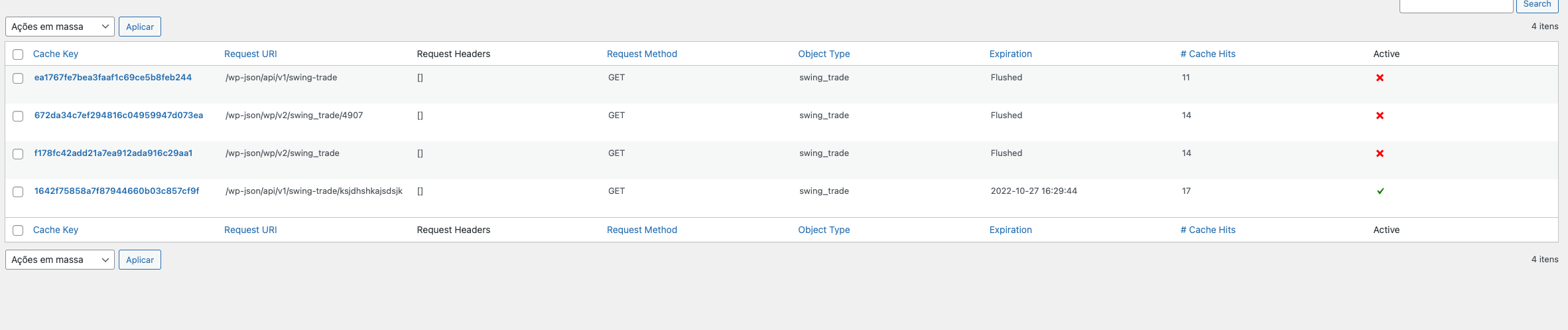

    In what way are you updating the data through cron? Which WP function do you use? Because if you use anything that triggers the save_post hook it should automatically clear the correct cache records.
    If you are using some kind of update mechanism that isn’t triggering the save_post hook, than you could indeed flush the records yourself using the functions you are already trying to use. However, if I look at your screenshot I see the object type is swing_trade and not ticker so are you sure you are using the correct object type?

    About the post type, it was just an example of what is happening. Actually I need to clear cache of more than one custom post type.
    For this reason, I tried to use the two ways above and the behavior was that of the attached image.
    I’ll try to change the approach a little, but what I do in my CRON is to give an update_field(), because I’m using ACF to update the values I need, I don’t use save_post().
    For example:
    update_field('potencial', 0, $post_id);
    Once the update is done, I call for each post type:
    \WP_REST_Cache_Plugin\Includes\Caching\Caching::get_instance()->delete_related_caches($post_id, post_type);
    \WP_Rest_Cache_Plugin\Includes\Caching\Caching::get_instance()->delete_object_type_caches(post_type);
    Do you have any other suggestions of what I can do?

    As long as the $post_id and $post_type are correct, I don’t see any reason why this approach wouldn’t work. So all I can ask now is: are you sure the $post_id and $post_type are correct? Are you sure the cron is executed? And are you sure the caches aren’t cleared?
    I know these are all question that bring the problem back to you, but at this point I don’t see any reason why it wouldn’t work.
