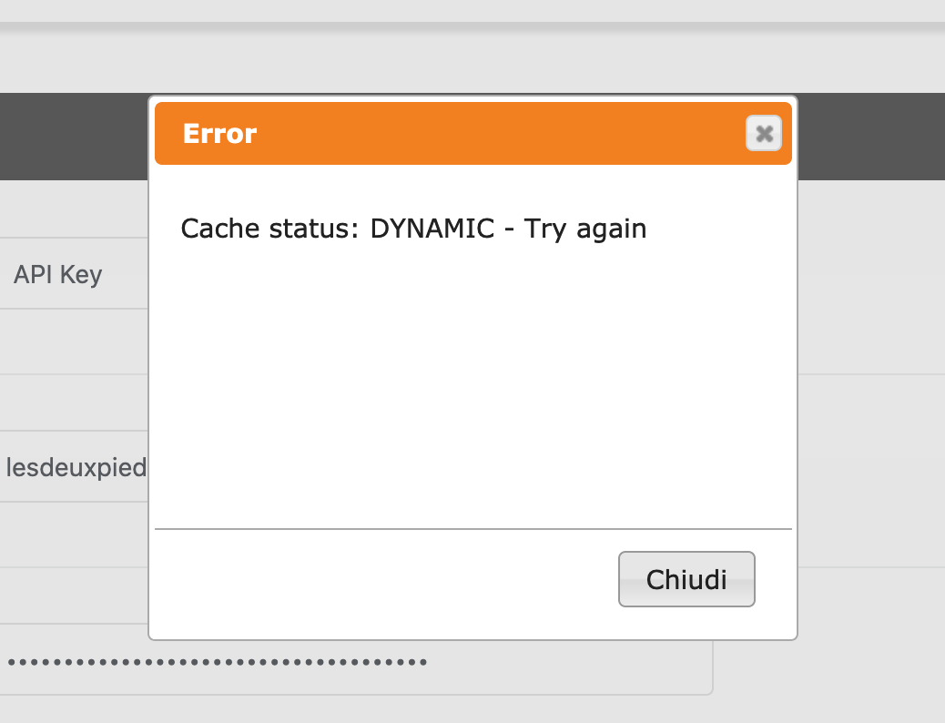

    What’s weird is I tried to enable caching now. I’ve got this error.
    Is it because I didn’t delete the page rules in CF ?

    1) The error above was there because I haven’t deleted my pages rules in CF account (sorry it was in your FAQ!)

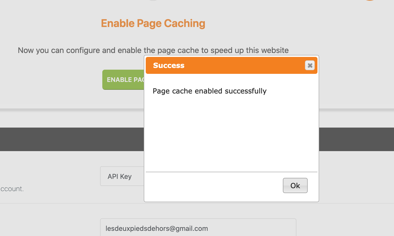

    2) Since it’s done, i got this.

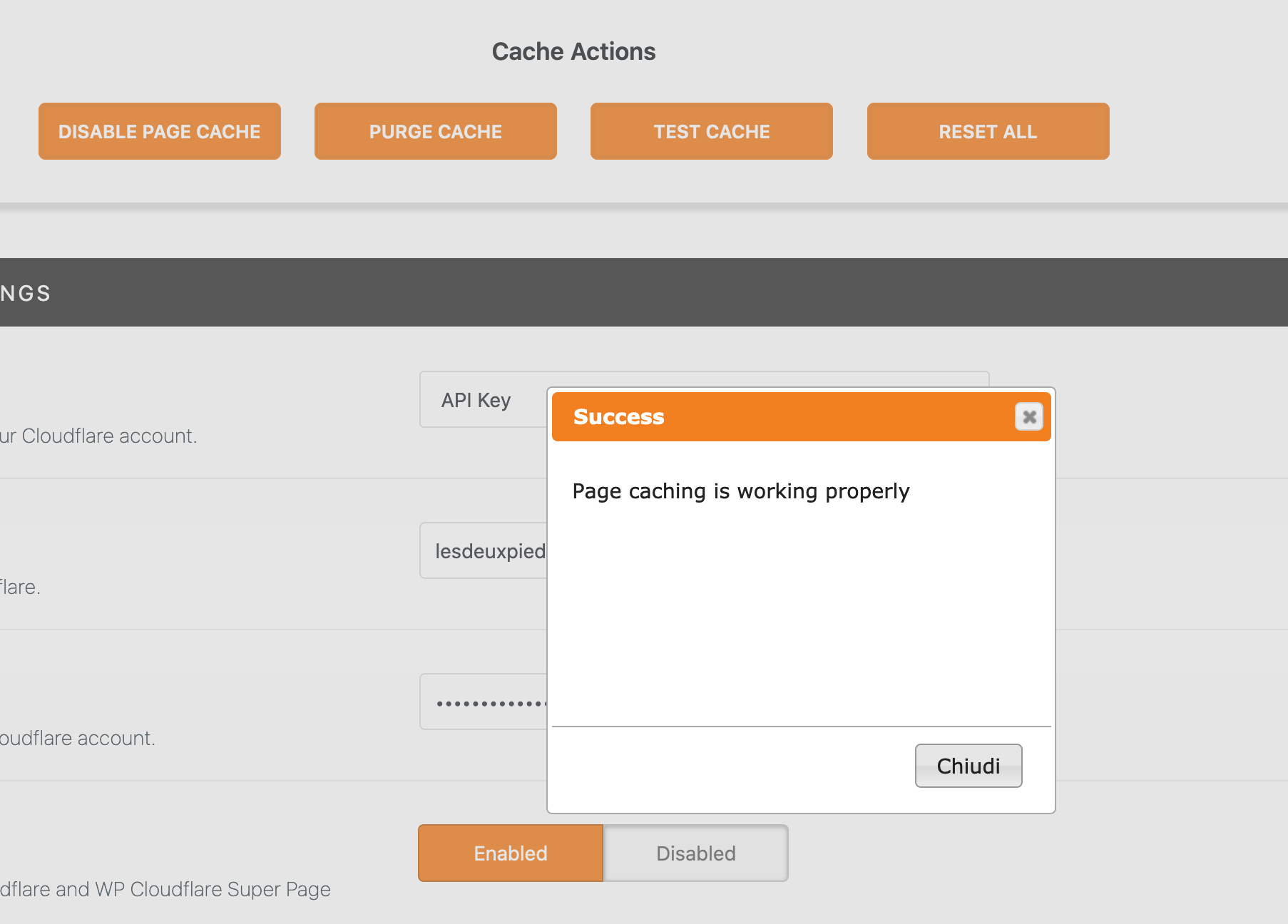

    3) Then I tried to “test cache” and I got this message so everything seems fine
