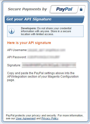

    Security header means the credentials are incorrect. It sounds like they didn’t send you the correct thing. I just checked that tool again myself, and this is what comes up when you log in with it (http://www.angelleye.com/images/forums/paypal-api-credentials-tool.jpg)
    I’m really not sure where they would have seen a “Fingerprint”.

    The first time you go through the API Credentials configuration manually it will ask if you want certificate or signature. They must have done that and chosen certificate.
