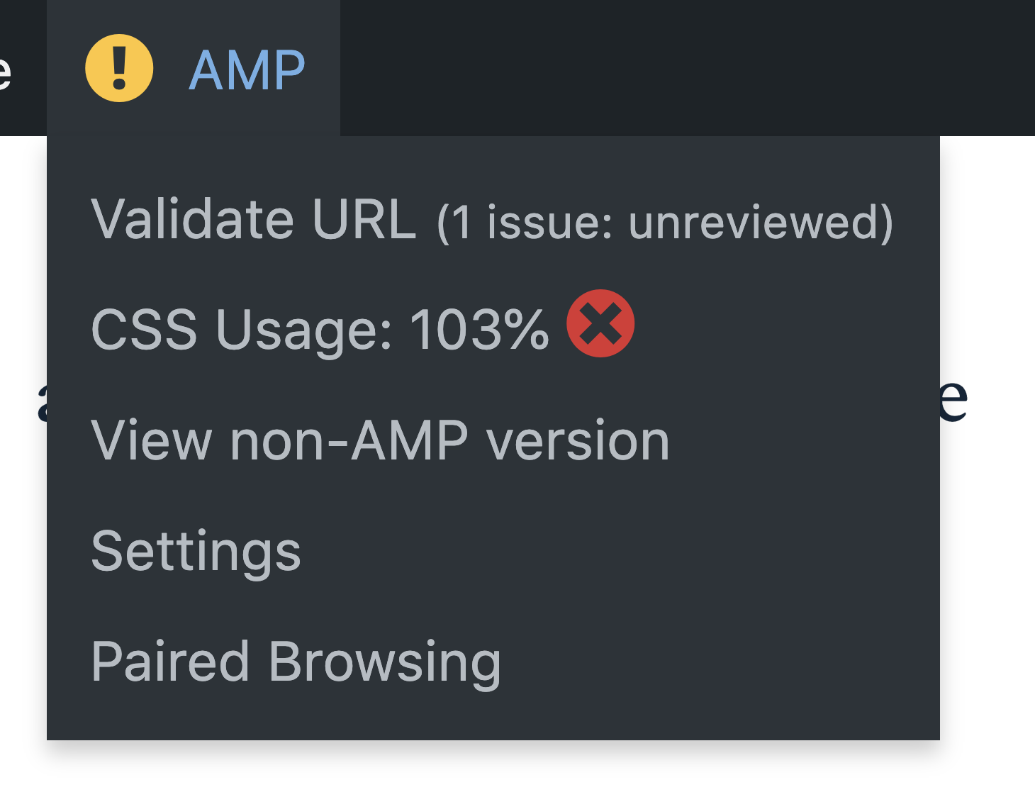

    I wanted to confirm that when I have Go active and I try accessing a post that has a large number of blocks, such as via the Block Unit Test for Gutenberg plugin, I get an excessive CSS error:

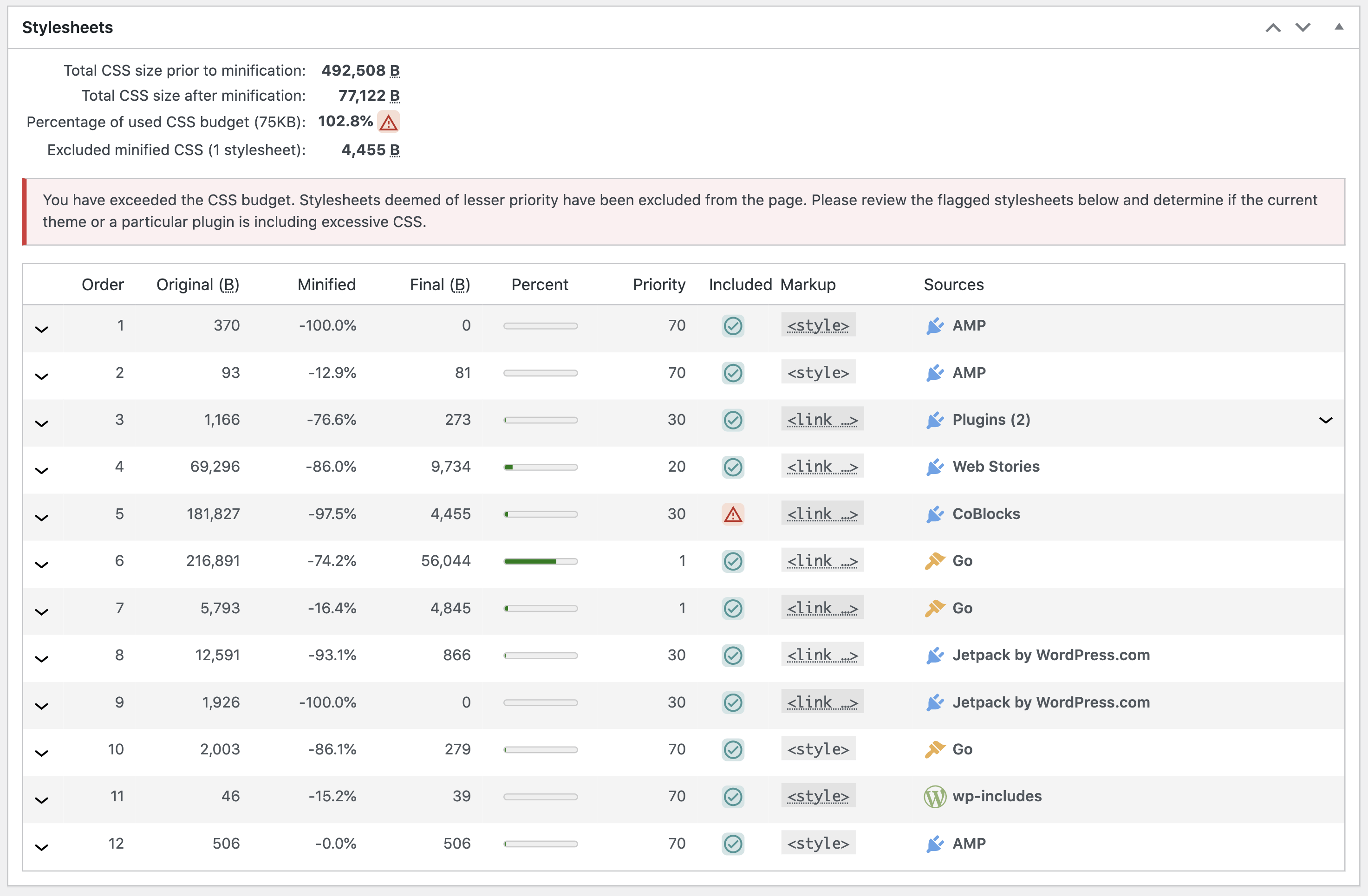

    The style-shared.css from Go is indeed very large:
    The AMP plugin was able to remove 74.2% of the CSS via tree shaking, which is quite good. However, because the total original CSS is 216KB, it’s just too much to be able to remove enough CSS to bring it down to to 75,000 bytes.
    When looking at the CSS, I don’t see a quick solution to reduce the size of CSS. So I’ve filed an issue with Go to see if this is something they can address at a deeper level: https://github.com/godaddy-wordpress/go/issues/673
