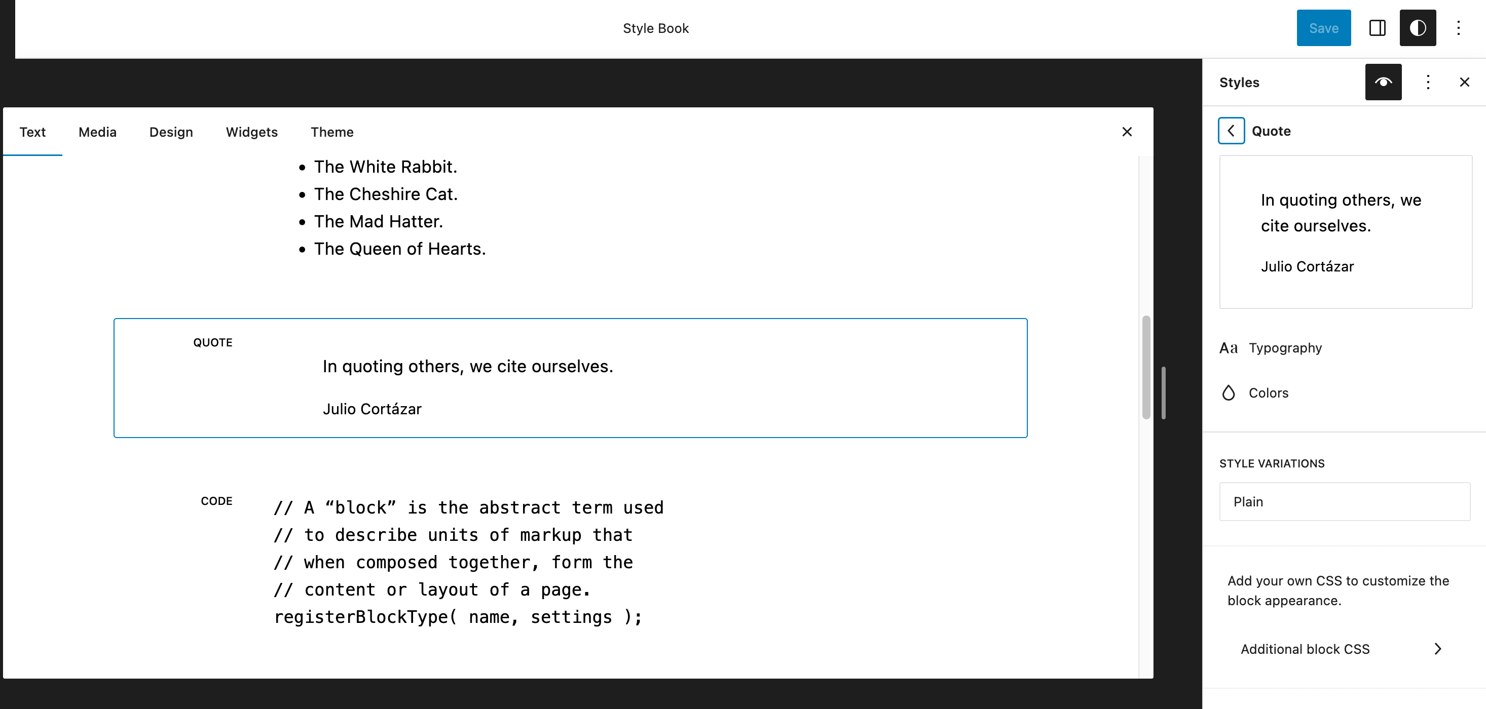

    Hi @adrean – the Quote block in this theme is “plain” and does not have a vertical line to the left of it, as you can see in the Style Book:
    To add a vertical line on the left, you can add some custom CSS in the CSS editor built into WordPress 6.2.
    You can try something like this in the site-wide CSS editor, varying the colour or width as you prefer:

    Thanks for the screenshot. You’re quite right, the two Quote block types do show up when adding the block to a page or post, even though they don’t both show in the Style Book area.
    After digging a bit more, it looks like the missing left border in one of the block variations is actually a bug, and there are already two related Trac tickets for it:
    https://core.trac.ww.wp.xz.cn/ticket/57506
    https://core.trac.ww.wp.xz.cn/ticket/57400
    Hopefully this will be fixed in an upcoming version of the theme!
