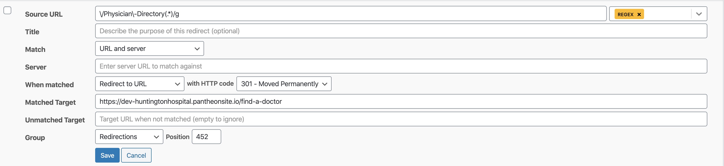

    You don’t need to escape the / and the /g will not work – it will look for /g on your URL.

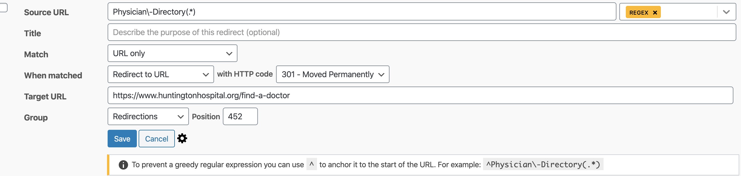

    So, this still isn’t working for me, which makes me sad because I was super proud I came up with a regex thing that seems to work. =)
    Screener of redirect.
    I’ve tried adding a dollar sign but that doesnt work either and nukes my match in the regex tester. Halp.

    Your original regex looks fine, but you don’t need the /g flag as that is not part of the regular expression. If you use https://regex101.com/ then it is not shown as part of the expression.
    The new one won’t match as it doesn’t include the leading /. When I said you don’t need to escape the / this meant you can put / instead of \/

    Thanks again for the swifty replies, John! We’re working now.
    This /Physician\-Directory(.*) did the trick.
