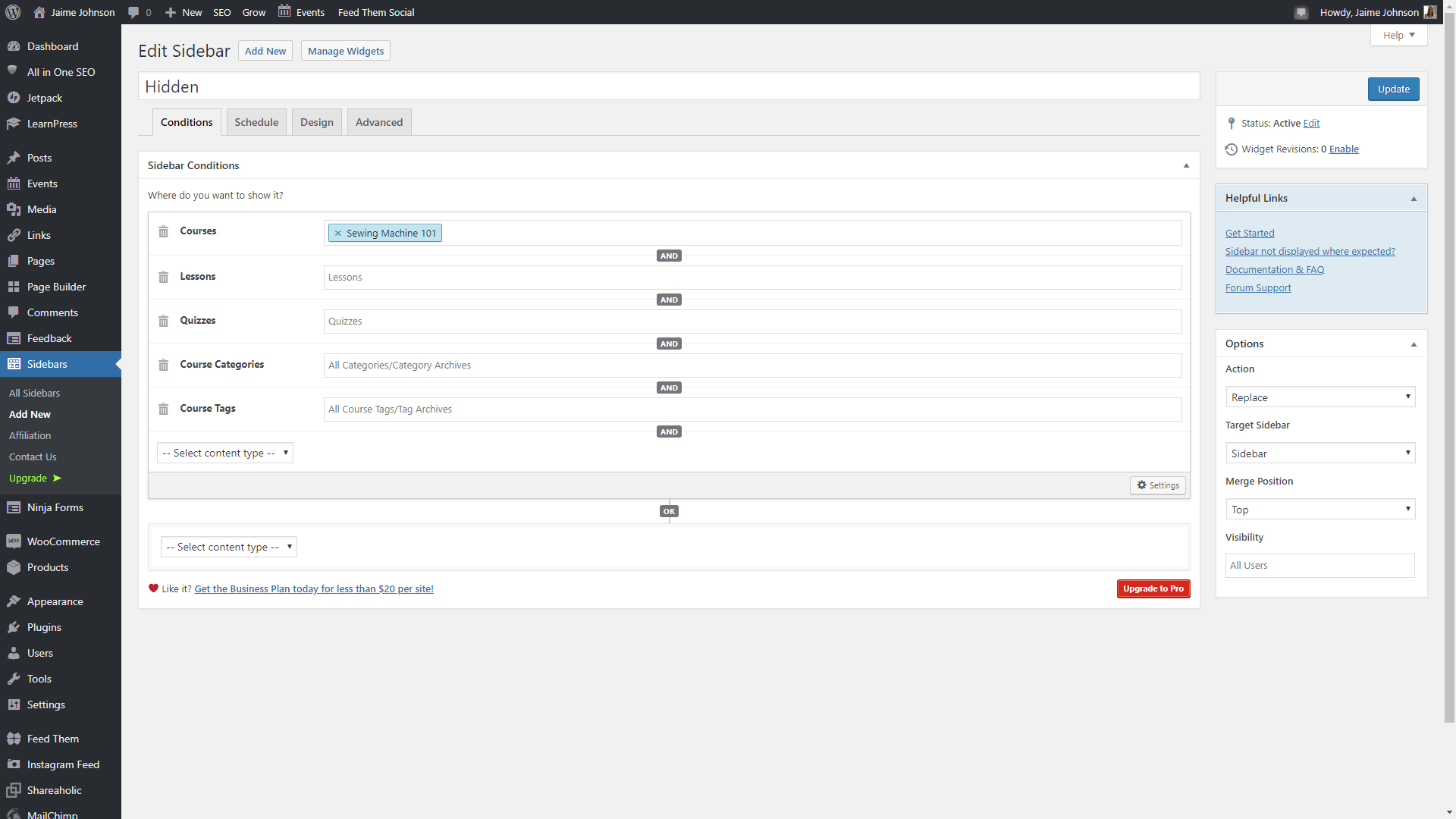

    Thank you for the screenshot.
    Try this:
    1. Remove all conditions but Courses: Sewing Machine 101
    2. Re-add the conditions you want, but make sure to use the OR-separator, so that it e.g. says Courses OR Lessons OR Quizzes
    When using AND the conditions are evaluated as a group, meaning that your current conditions would only work for a page that is a lesson AND a course AND a quiz AND …
    This also makes the AND-separator very powerful: You could add a sidebar for a Course in a specific category, a Lesson created by a specific author, etc.
    Please let me know if you have questions about this!
    Thread Starter jaimesews
    (@jaimesews)
    Thank you so much, that fixed it!
