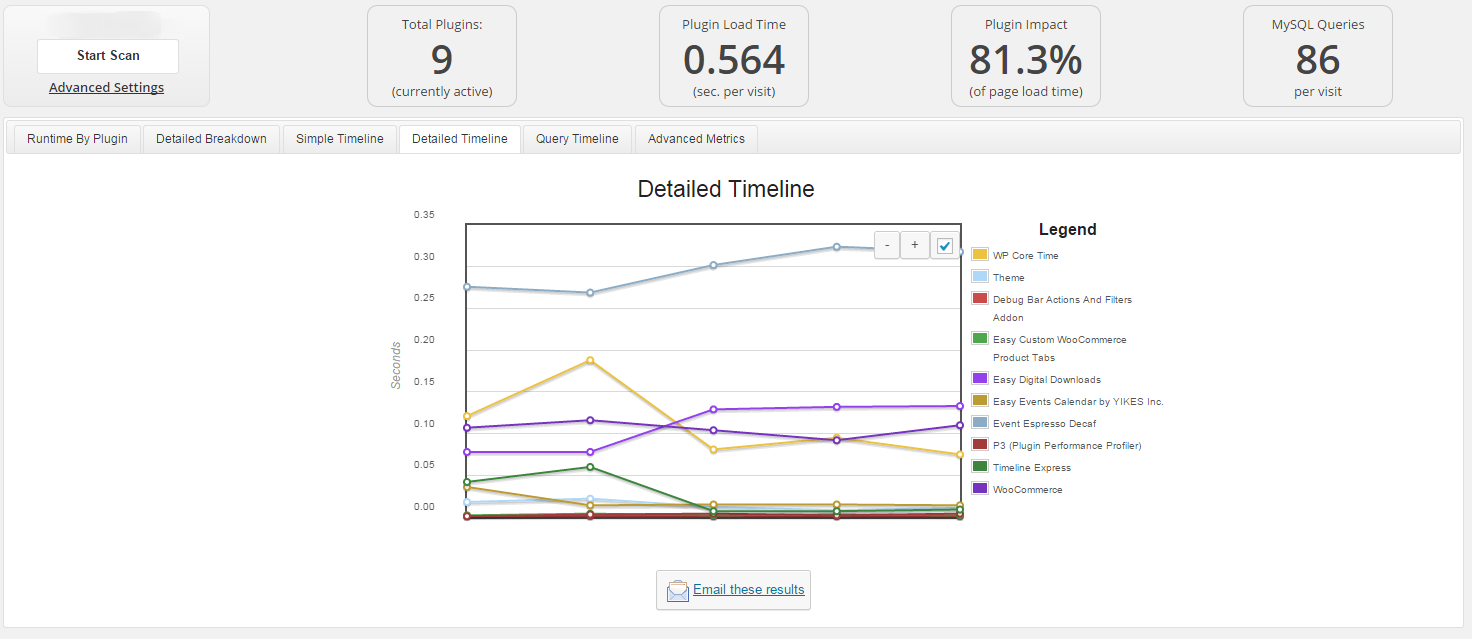

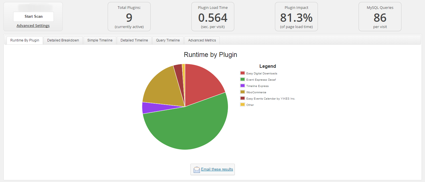

    I took a look into the issue and there were a few functions that were firing on the front end that shouldn’t have been, but they weren’t very resource intensive.
    My guess is that you were running the p3 profiler on auto mode, and it was running through the backend admin pages of your site, which it does load a few more resources.
    I ran p3 profiler a few times and noticed that it would spike high at the end of the scan, and by checking the ‘Detailed Timeline’ tab I could see that the last two spikes were coming from the dashboard.
    Here are two screenshots of running an manual scan only browsing through the front end pages of the site.
    https://cldup.com/ZsB6AqB1b8.png
    Here is the detailed view of the plugin on the front end. You’ll notice that the plugin is the green line, and one of the less resource intensive plugins. I believe on whichever page you’re displaying you’re timeline on , the plugin loads masonry, a js file, a css file and font-awesome unless your theme is loading it.
    https://cldup.com/W_uSYqoZ3I.png
    Either way, I’ve shifted a few things around and pushed out a minor update which may speed up a few things on your end. You may want to double check what pages are causing the spikes, because I don’t believe it’s on the front end of your site and causing any page loading speed issues for your users.
