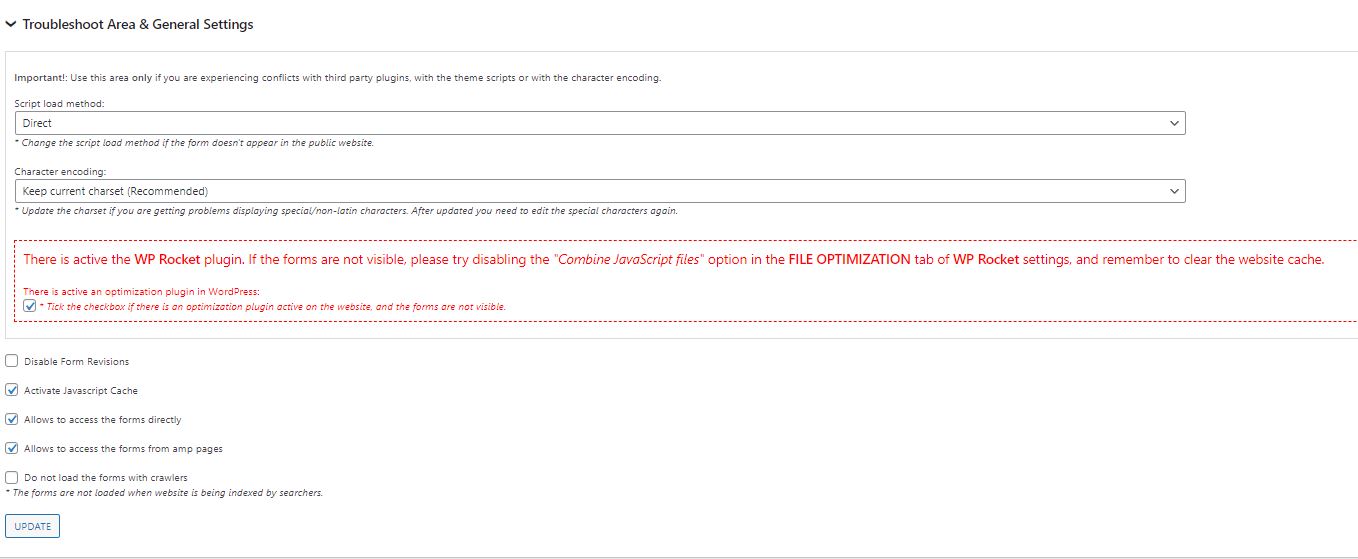

    Hello @codepeople
    What option do you have selected through the “Script load method” attribute in the menu option “Calculated Fields Form > Troubleshoot Area & General Settings”?
    Best regards.
    Thread Starter pexel
    (@pexel)
    https://i.hizliresim.com/1eh92jg.JPG
    Should I change all buttons like this? Playing with this setting scares me now.
    • This reply was modified 2 years, 7 months ago by pexel.
    Plugin Author codepeople
    (@codepeople)
    Hello @pexel,
    Please select the “Classic” option and press the “Update” button. Once you modified the script load method, purge your website and browser caches and let me know to check your form again.
    Best regards.
    (@pexel)
    I have now made the changes as you said. I would like to ask you which functions should I use in the current “Calculate” and “Clear” buttons? I will revise all forms according to the coding you specified.
    (@codepeople)
    Hello @pexel,
    Excellent !!!
    That was the modification we recommended to you from the plugin website.
    Now, the reset code would be as simple as follows because there is only one instance of the jQuery library on your page:
    RESETFORM(this.form);jQuery('[data-cff-field]').html('');
