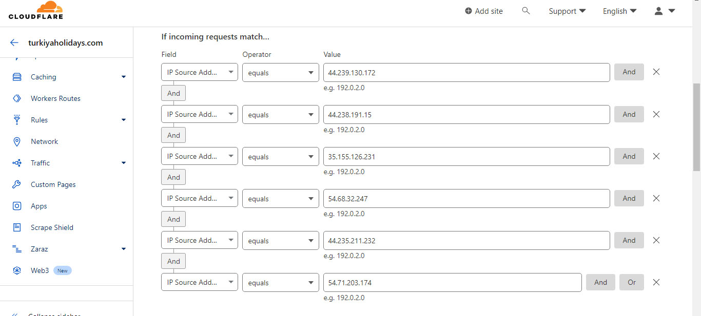

    so l have did what you asked me in screenshot and only added the maximum execution time to 20 the other settings was correct and on cloudflare did that earlier this in the screenshot
    https://turkiyaholidays.com/transfers/wp-content/uploads/2023/09/cloud.jpg

    There may be further steps you need to take at your end but I will try to make things as clear as possible. If we see your diagnostic for ourselves, we may be able to see exactly which configuration item needs to be changed.
    Visit the Wordfence > Tools > Diagnostics page to send that over to us at wftest @ wordfence . com. Click on the “Send Report by Email” button. Please add your forum username where indicated and respond here after you have sent it.
