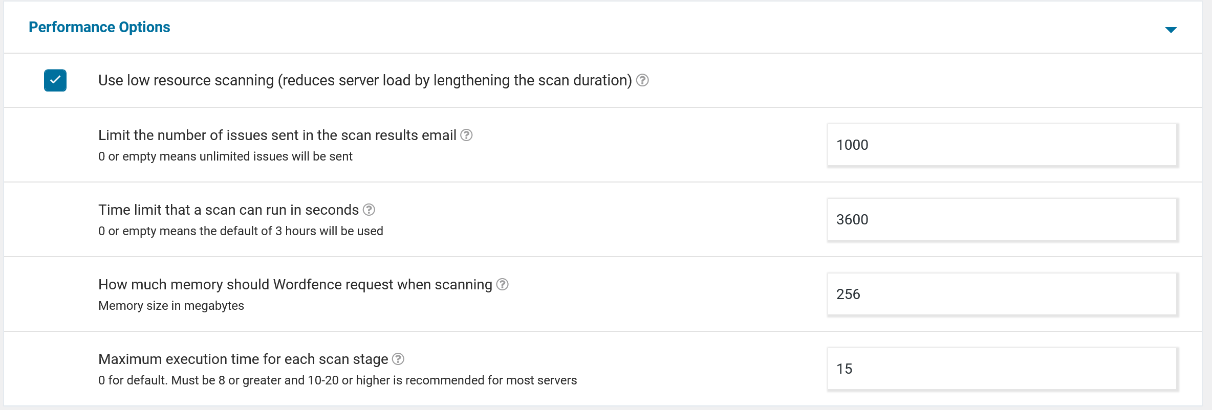

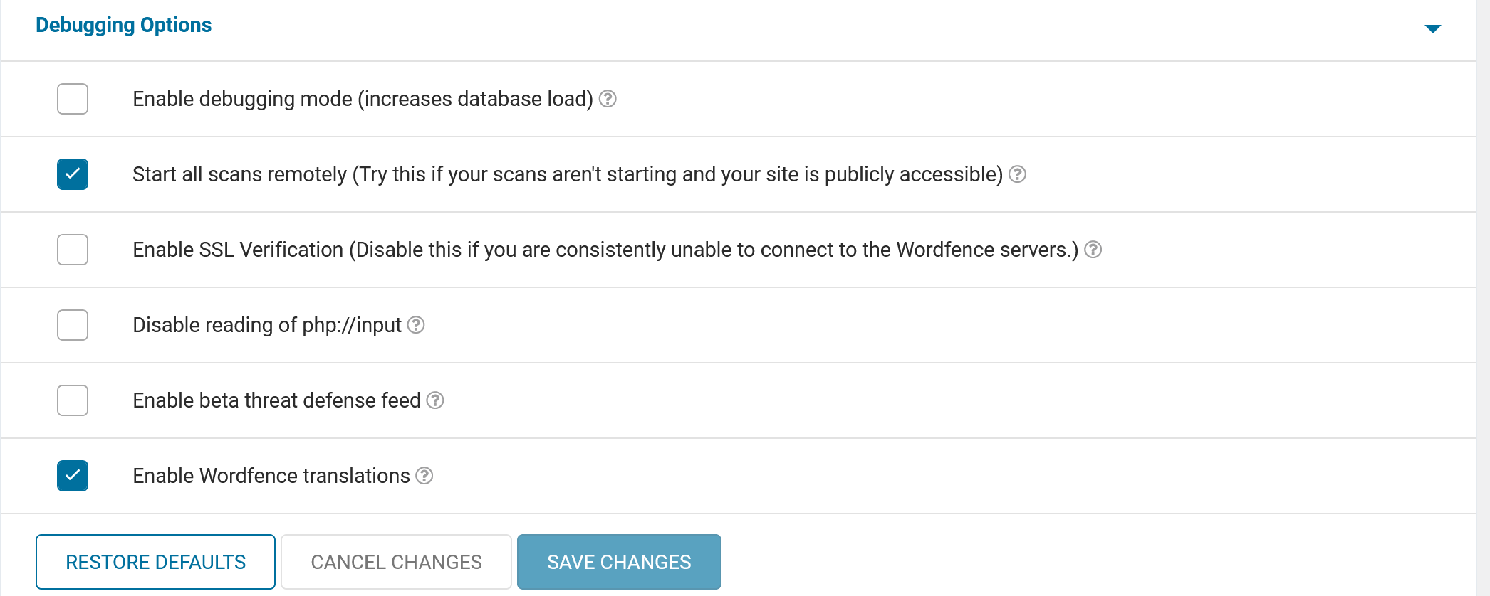

    Can you screenshot your Wordfence > Scan > Manage Scan > Performance section for me to review?
    Also, could you screenshot your Wordfence > Tools > Diagnostic > Debugging section as well.

    Hi WFAdam,
    Here are links of screenshots you requested.
    https://easycaptures.com/fs/uploaded/1467/6791418148.png
    https://easycaptures.com/fs/uploaded/1467/2853510513.png
    Thanks at advance for your support.

    Thanks for sharing that!
    In the first screenshot, can you adjust the following:
    Time limit that a scan can run in seconds from 3600 to 0.
    This will adjust the allotted scan time from 60 minutes to 3 hours.
    In the second screenshot, can you adjust the following:
    Enable Enable debugging mode (increases database load)
    Disable Start all scans remotely
    Enable Enable SSL Verification
    Then try to run another scan. Wait until it completes or fails. If it fails, copy the last 10 lines of the scan log on the Scan page for me.
