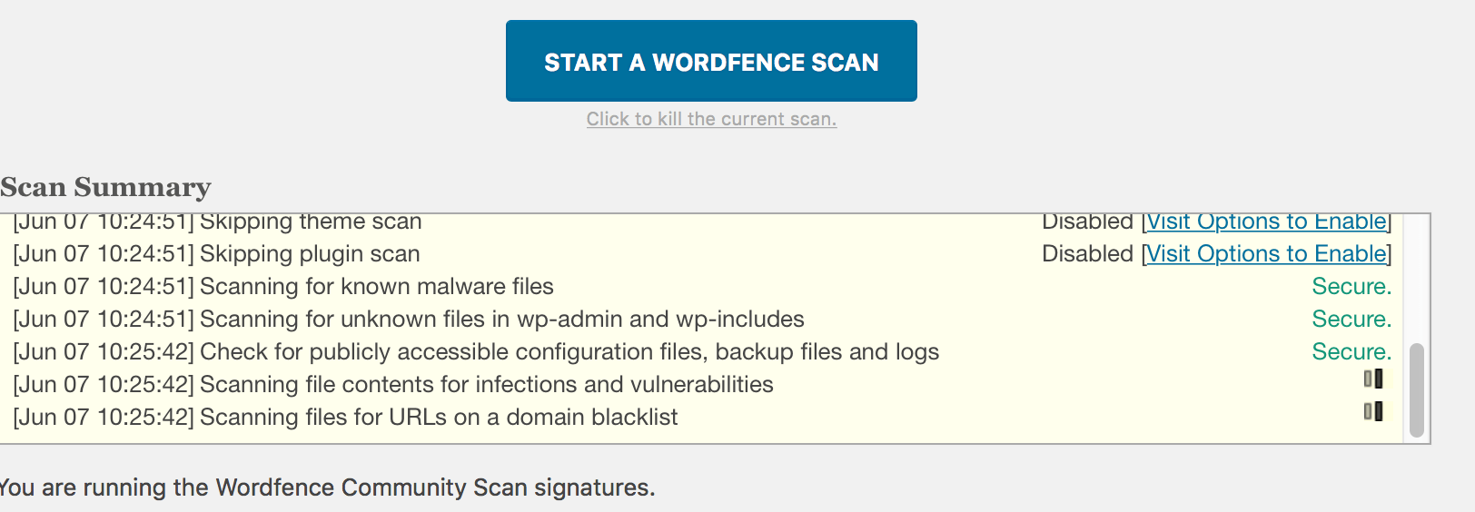

    Hi when I try and scan it gets to this stage:
    Scanning file contents for infections and vulnerabilities
    [Jun 07 10:25:42]
    Scanning files for URLs on a domain blacklist
    And then just does nothing. I’ve tried to kill the scan and start again but same result. Yesterday got alerted by 1&1 of a suspicious file and luckily they sorted it. But now I’m worried. How can I make the scan work?
    Many thanks
    J
    Screenshot

    Please turn on “Enable debugging mode” option -temporarily- under (Wordfence > Tools => Diagnostics) and run a new scan after that, keep watching for any error message that might appear in the activity log, sharing the last 20 lines of the scan activity log would be helpful too, you can use “pastebin” to share large text.

    Thanks tried that but still just hangs?
    Also I have this as last entry after which it just hangs:
    php/src/data/elasticloadbalancingv2/2015-12-01/api-2.json.php (Size:42290B Mem:77.0M)
    [Jun 08 08:33:11] Scan process ended after forking.
