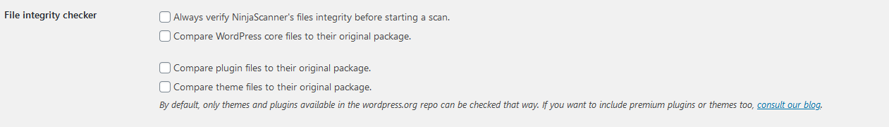

    Regarding the first scan, it stops after 1 second only and when trying to download the WordPress zip file. Can you try to disable “Settings > Advanced Users Settings > Compare WordPress core files to their original package” and run the scan to see if it still stop after one second? If it does, then disable the two other options from the “File integrity checker” section and try again. That will show whether there’s an connection issue or not.

    For site 1, disabled all 3 of these settings, but does the same thing: https://i.gyazo.com/2c9ed7135afb3067f19077c114628bce.png
