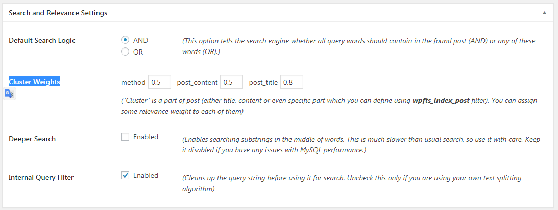

    Also please check if you have the “product_content” cluster added to WPFTS Settings / Main Configuration / Search and Relevance Settings / Cluster Weights
    https://e-wm.org/i/E20190801-205333-001.png
    If you can see the cluster there, it means data was indexed correctly.

    As he tests in a sandbox, he returns a wrong result. When entering in Search Tester “1080” returns the wrong product. 1080 is part of the class name from Guttenberg. Therefore, it copies and saves the title + content in the postmeta under the key _product_content. This is my configuration https://ibb.co/m9FsS8w.

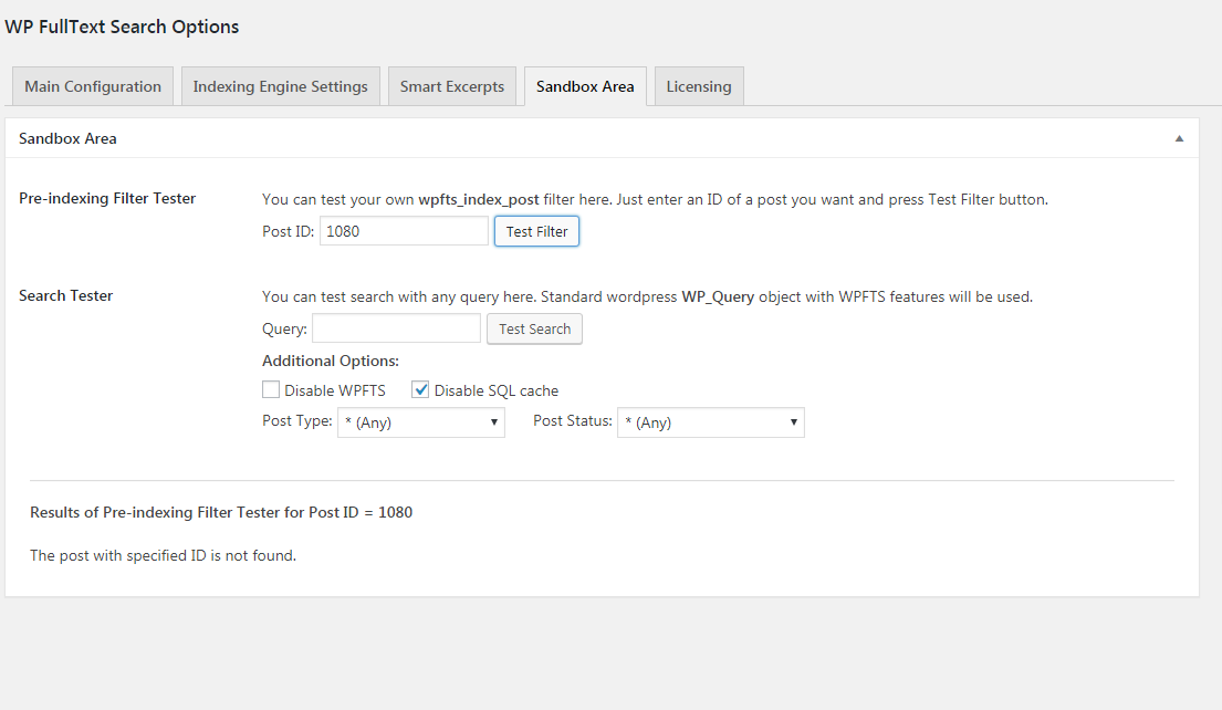

    I enter it in: https://ibb.co/HN3nXHx . And I would like it to work in the main search engine as well.

    Please explain why you are looking for “1080”? Is this post_id or the query string which you are looking for?
    Try to enter 1080 to the TOP INPUT, which reads “Post ID” and press top button.

    https://ibb.co/MB7dy41. ID is looking good. Additionally, it shows _product_content correctly. But I do not want to enter post_id just a phrase or title.
    Plugin Author Epsiloncool
    (@epsiloncool)
    Alright! So 1070 is your post ID.
    And it looks like your wpfts_post_index function works correctly.
