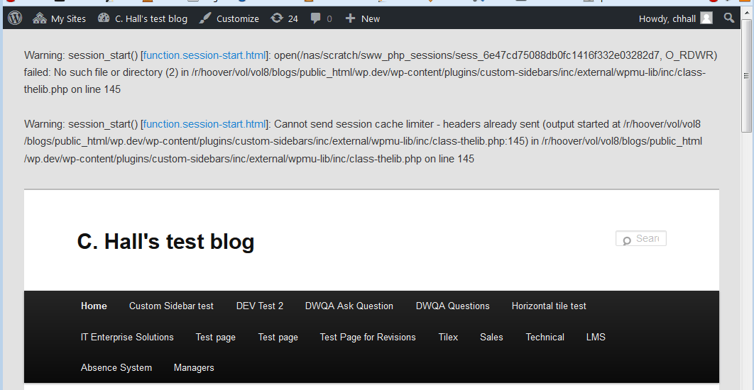

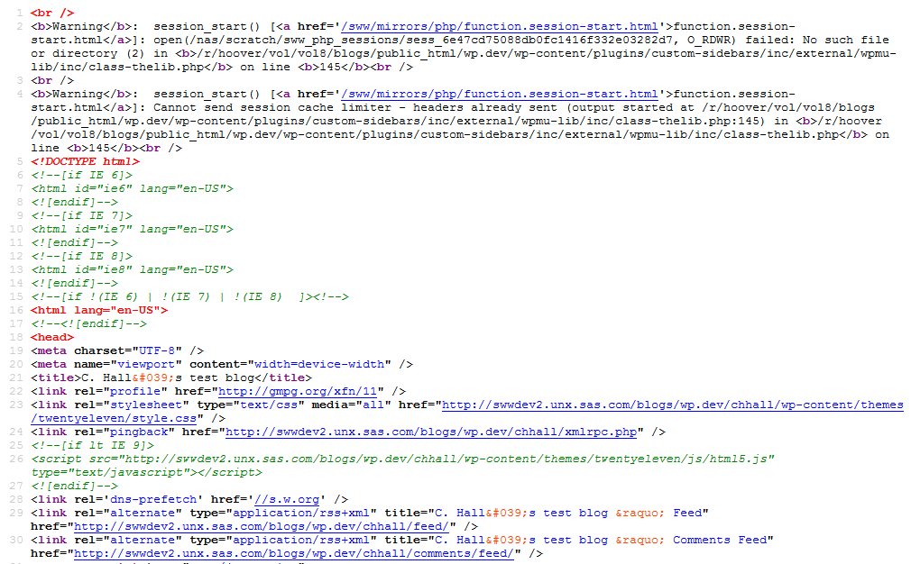

    Thanks Predrag. I am attaching a screen shot of the page and the View Source.
    Error displayed
    View Source

    FIXED! This turned out to be a missing directory. We have PHP configured to store session data in a particular directory… and somebody deleted it.
    So sorry to have falsely accused poor Custom_Sidebars. It was completely innocent. It just happened to be the first snippet of code to try and begin a session.
    You’d think I’d have gotten errors from all over the place, but maybe WordPress turns off the warnings at some point.
