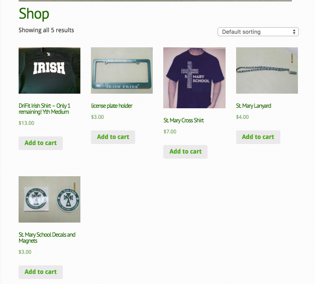

    This is the shop page content https://dl.dropboxusercontent.com/s/hsznto03o1smp8f/2016-01-28%20at%2016.01.png?dl=0
    The stuff above is content you should have removed if you went with the ‘woocommerce.php’ template method of theming.

    Ok, I’m entering my product information through: Products>Add product on the navigation menu on the left.
    How do I remove the content above? I tried to follow the instructions to change the .php templates. Do you need to see some of what I did?

    I need to see your woocommerce.php template file if you made one.

    <?php get_header(); ?>
    <div id=”main-content” class=”clearfix”>
    <div id=”left-area”>
    <?php get_template_part(‘includes/breadcrumbs’,’page’); ?>
    <div id=”entries”>
    <div class=”entry post clearfix”>
    <?php get_template_part(‘loop’,’page’); ?>
    </div> <!– end .entry –>
    <?php woocommerce_content(); ?>
    </div> <!– end #entries –>
    </div> <!– end #left-area –>
    <?php get_sidebar(); ?>
    <?php get_footer(); ?>
    Plugin Contributor Mike Jolley
    (@mikejolley)
    Remove:
    <div class="entry post clearfix">
    <?php get_template_part('loop','page'); ?>
    </div> <!-- end .entry -->
    Thread Starter KayCorcor
    (@kaycorcor)
    THANK YOU! I really appreciate the help!
