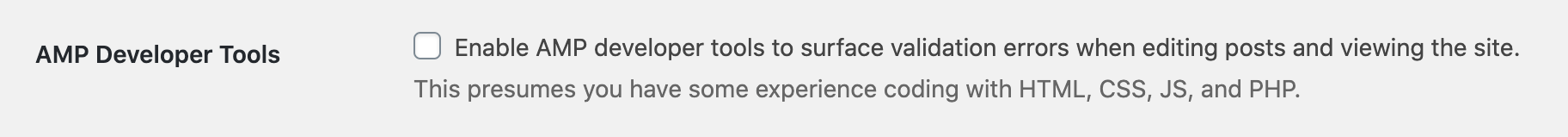

    Do the performance problems go away when you turn off AMP Developer Tools in your WordPress user profile settings?

    No, not deactivate the AMP plugin as a whole. I’m talking about “AMP Developer Tools” in your WordPress user profile settings:
    AMP Developer Tools toggle

    Turning off developer tool no effect, same slow admin issue.
