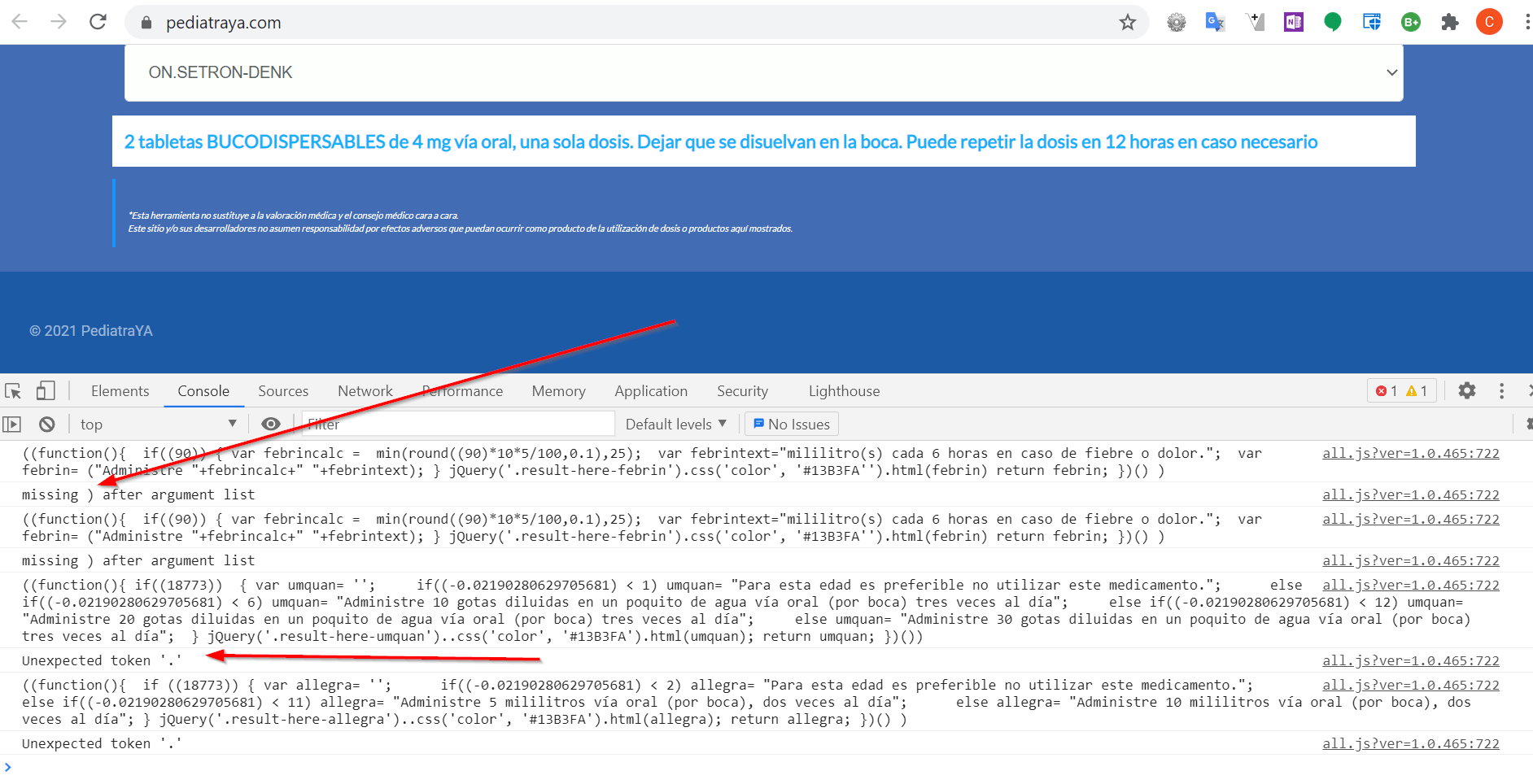

There are some errors in your equations, please, look at the screenshot below:
Best regards.
