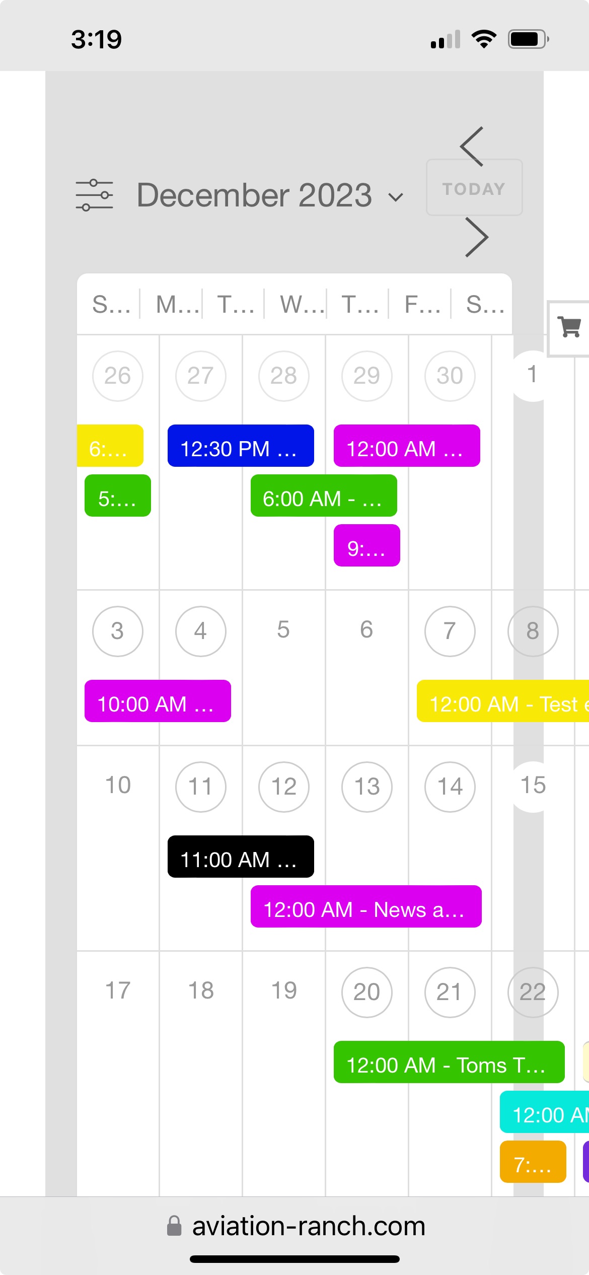

    HI, I have a calendar that is not scaling correctly on a small screen. Looks great on a desktop. Looks great on a tablet and even on a phone if you hold the phone horizontal but, stand your phone upright and the dates and events go off the screen.
    No idea what to do to fix.
    Let me know what I need to do. Please be super (step by step) specific. I do not do code and I despise this block thing. Had to have been created by a “Block Head”
    Since I do not understand this block thing I can not insert a photo. Managed ONE TIME to get a photo to load. Tried more than two dozen times. So since the odds are better to get struck by lightning… Here is the url to show you what I am seeing on my phone.
    http://aviation-ranch.com/image/calendar.jpeg

    I do not believe it has anything to do with the Beaver Builder. I turned that off and the page still does the same. The Short Code in the block on the page reads as follows.
    [events_calendar long_events=”3″ calendar_size=”large” limit=”6″ has_search=”1″ scope=”all”]
    I think there is something else I should have in there but I do not know what it should be.
    The reason it’s not working correctly on the phone is because you have the options long_events=3 and calendar_size=”large”. If you remove these options then it will display correctly on the phone but it won’t display correctly on larger screens. In order to fix this add the following PHP code:

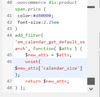

    Thank you for trying to help. I went into the customize screen and added the code to the “Custom Code” window and it did not seem to do anything. It had different colors than the other code i have added. I do not know what that means.
    I also watched the video you linked to. SO OVER MY HEAD. I have a hard time getting stuff I understand to work so new stuff takes more brain power than I have. I am a 64 year old stroke survivor.
    Here is what I am seeing when I add the code.
    https://aviation-ranch.com/image/AddcodeB.png I am pretty sure the colors of the letters mean something but I do not know what.
