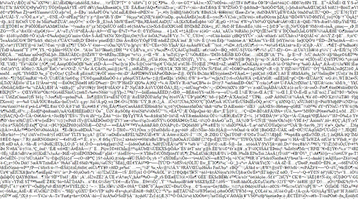

• Hi, after upgrading to W3 Total cache 0.9.5.2 (we have wordpress 4.6.1) we get a random problem – some of our posts appear to the end users as garbage. Like this: http://prntscr.com/dxvd6m Repeated browser refreshes and cache clearing (on the browser and on the W3Total cache backend) doesn’t solve the problem. The only thing that seems to solve it is when I turn off browser caching in W3Total cache settings. Is it possible to diagnose or roll back the plugin version?

    Whole page loads with eg ���n��ʲ���v�?K
    Pages load correctly only if reloaded multiple times.
