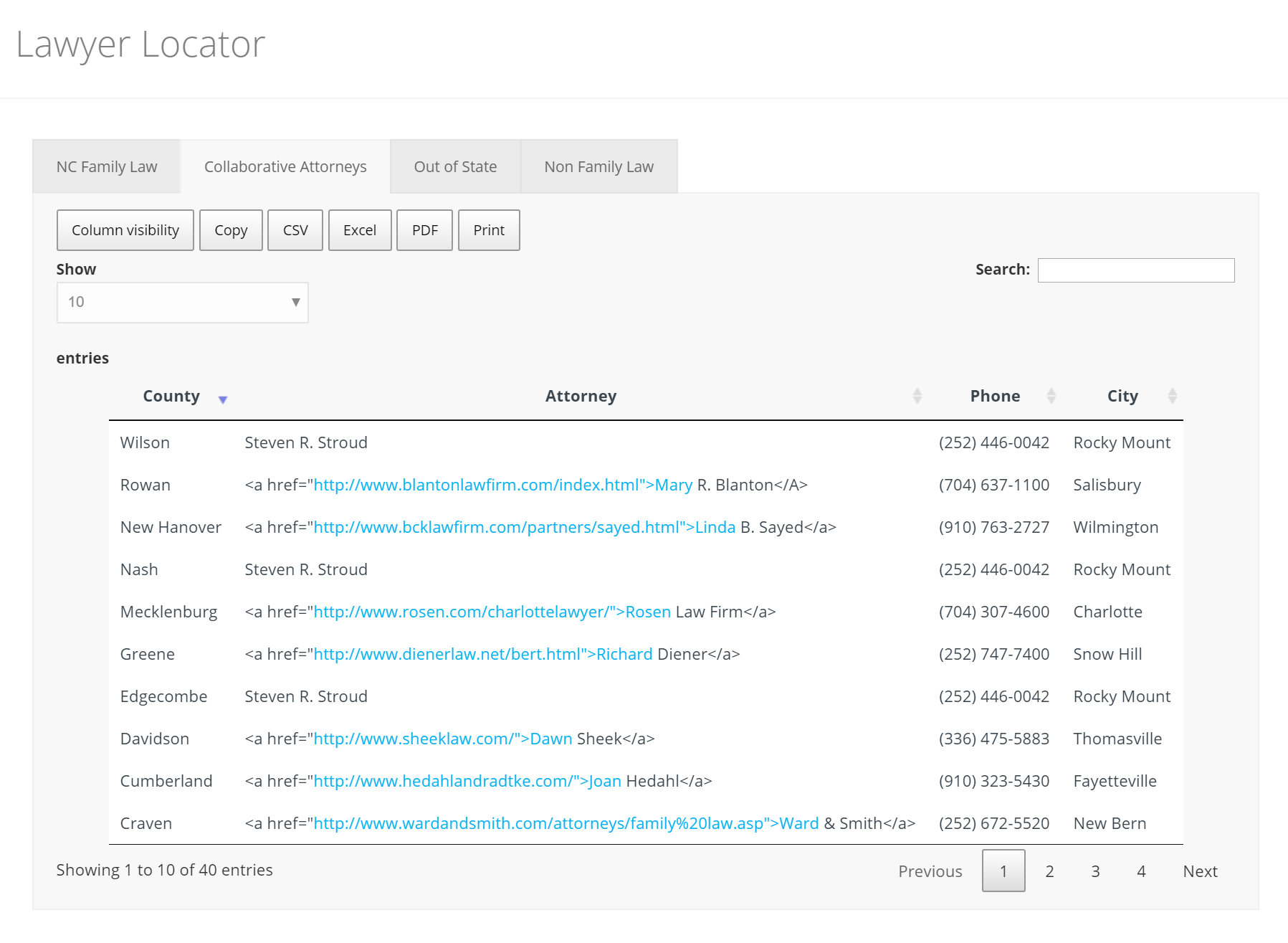

    We’ve been using your plugin on our site for a while but have started encountering issues. It seems like some of this was due to the Google URLs requiring a value like /edit at the end of the link, but one issue seems to have arisen that wasn’t there before. For some reason, some of the sheets aren’t displaying fully until you click an arrow on the “county” section.
    This is what it looks like when people first view the sheet: https://www.rosen.com/wp-content/uploads/2017/05/Spreadsheet-Screenshot-02.png

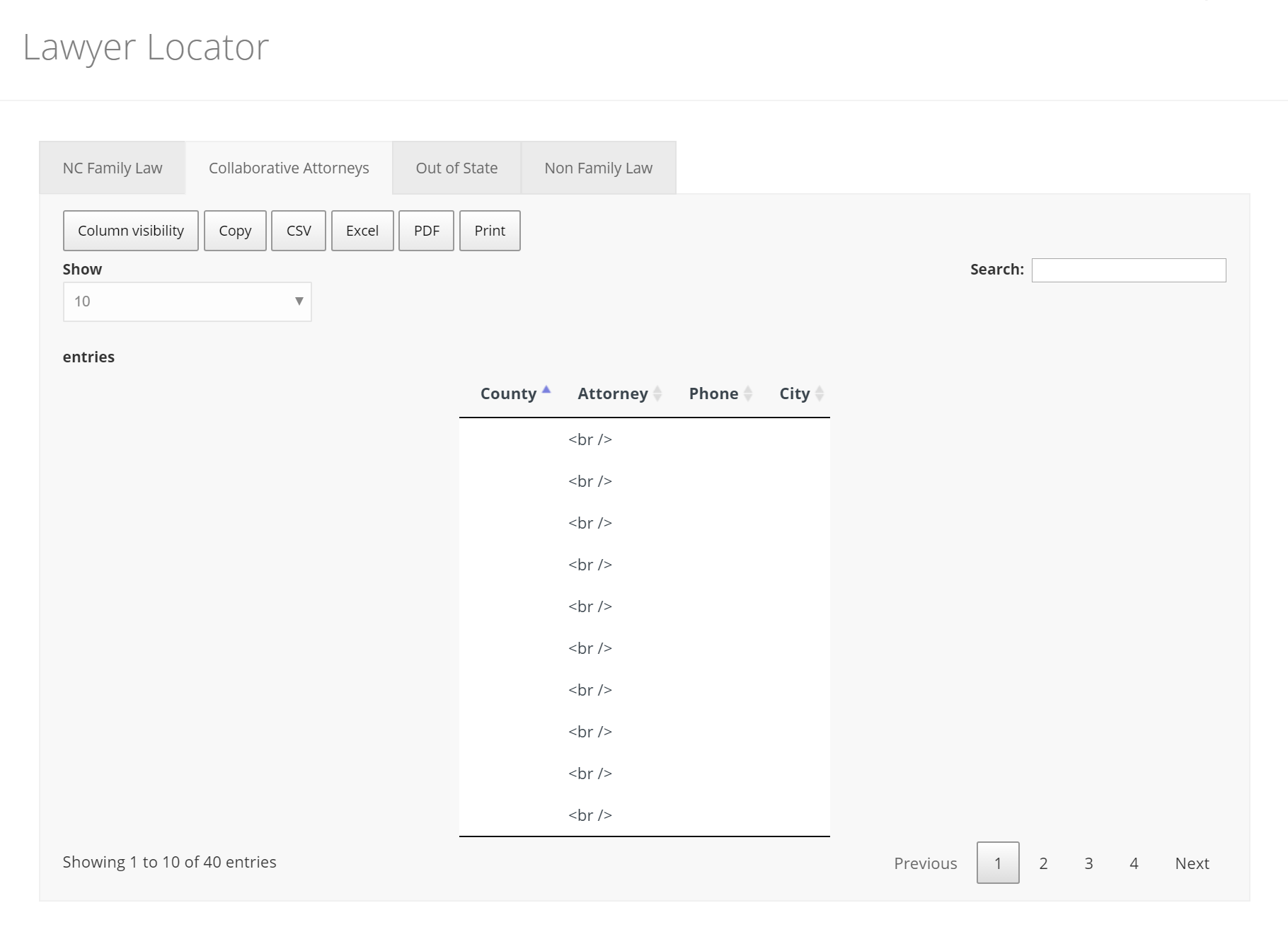

    After they click that arrow to the right of “County”, it displays the way it should (ignore the “a hrefs”): https://www.rosen.com/wp-content/uploads/2017/05/Spreadsheet-Screenshot-03.png

    The display issue is almost certainly because you’re using the shortcode inside a tabbed view. See other posts on this forum about that.
    As for the <a href stuff, um, you should probably fire that person and/or ask for your money back. You don’t need to patch this plugin to make HTML work. In fact, you shouldn’t, because it’ll stop working when I release an update. There’s a sticky thread on this forum that describes how to do that. Secondly, if they do it right, the fact of using old or new style Google Sheets will have zero impact on the HTML output.
