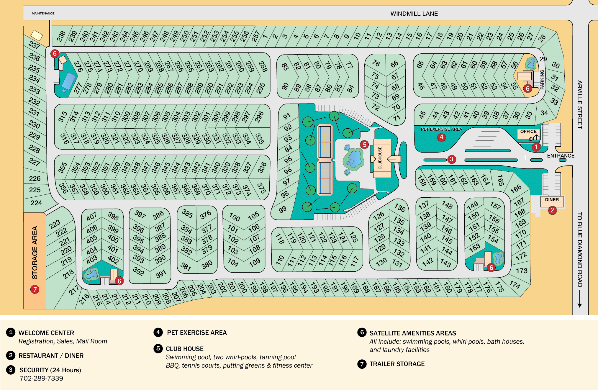

    I’ve switched to using a a PDF viewer but I prefer the LeafLet image option. Any suggestions to reduce the initial zoom level on a larger image file?

    If you have time to adjust some of the source code, I’ve had some luck with this:
    [leaflet-image source=http://lvmr.designwebstudios.com/wp-content/uploads/2019/04/[email protected] zoom=1 height=600 width=100%]
    And adjust line 74 in shortcodes/class.image-shortcode.php to be:
    projected_zoom = zoom + 2.2,
    seen here: https://github.com/bozdoz/wp-plugin-leaflet-map/blob/master/shortcodes/class.image-shortcode.php#L74
