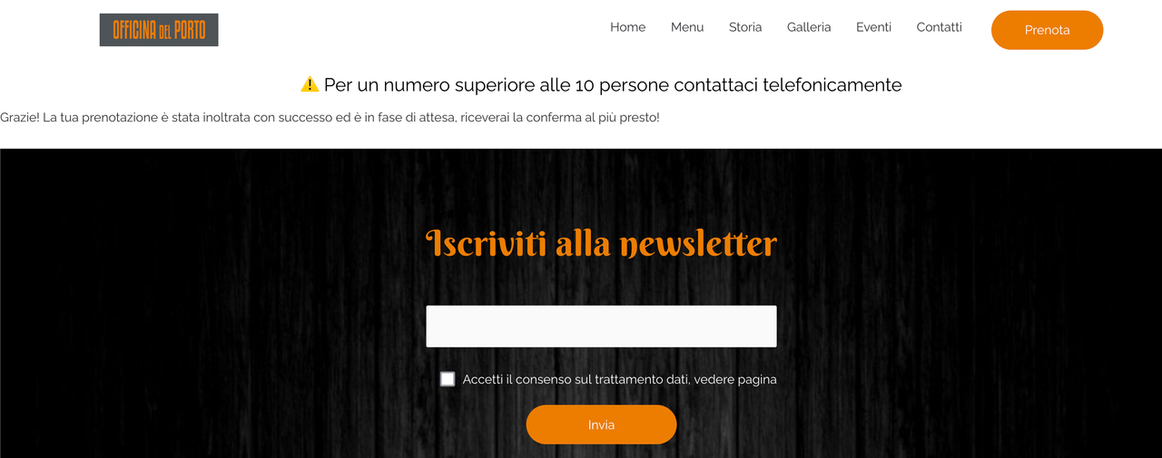

    That looks right and sounds good. I just tried booking on your site, both on desktop (you will see the booking under the name Five Star) and on mobile (you will see the booking under the name Star Five). Both were for this Saturday at 19:30 and both were successful. Here are screenshots of the thank-you screen for both:
