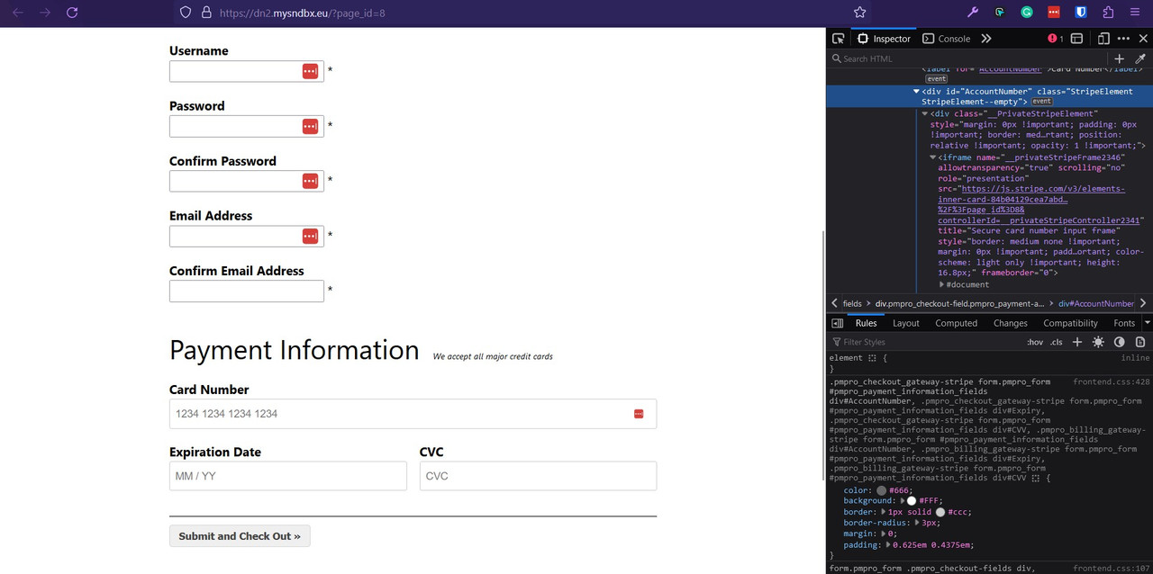

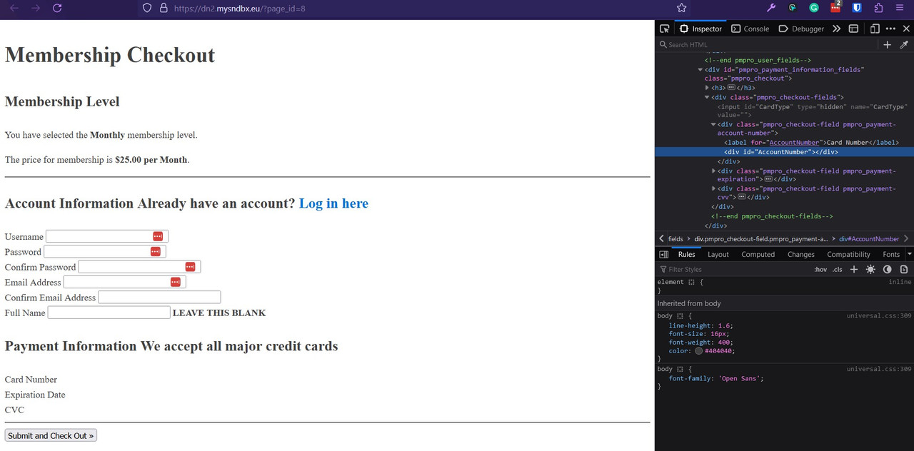

    1. The Stripe payment gateway doesn’t work with Oxygen. When Oxygen Builder is active, the fields for entering card details won’t load. Can you test this on your side? If you don’t have Oxygen, you can try it here https://oxygenbuilder.com/try/. Oxygen active: https://i.postimg.cc/85qt0zk0/oxygen-active.jpg, Oxygen inactive: https://i.postimg.cc/DzRr2YVW/oxygen-inactive.jpg

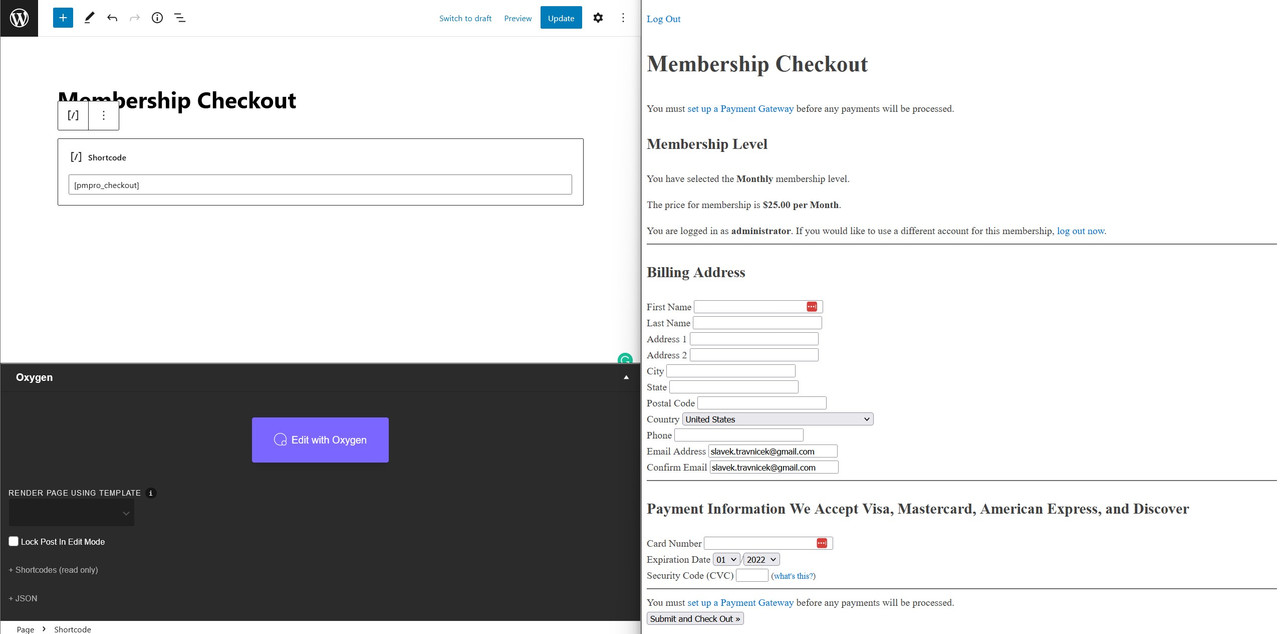

    2. The page shortcodes (https://www.paidmembershipspro.com/documentation/shortcodes/page-shortcodes/) don’t render when I insert them in the Oxygen Builder. Here’s an example for [pmpro_checkout]: Inserted with Gutenberg: https://i.postimg.cc/P5yL3VrG/gutenberg.jpg, inserted with Oxygen: https://i.postimg.cc/L5k4qhJd/oxygen.jpg.

    I managed to solve the Stripe problem, it’s working now. That leaves the questions about conditions and shortcodes.

    Thank you for reaching out to Paid Memberships Pro, I am looking into these issues and may need to take a bit of time.
    We do not natively support Oxygen Builder as we do some other page builders at this point in time, if Oxygen Builder supports blocks within their editor I recommend using that within the Oxygen Builder for now.
    I am testing issues about shortcodes not rendering in their builder, it may be best to reach out to their support team to help investigate this issue as well.

    The shortcode [membership] is indeed working within the Oxygen, so it’s a good alternative to the conditions.
    …if Oxygen Builder supports blocks within their editor I recommend using that within the Oxygen Builder for now
    Do you mean if it’s possible to insert Gutenberg blocks in Oxygen? I think that’s not possible.
    Anyway, it’s weird that [membership] works but [pmpro_checkout] doesn’t.
    I don’t know how to describe this, but isn’t it that [membership]inserts just some element while [pmpro_checkout] inserts a whole page template? I will ask Oxygen’s support team too.
