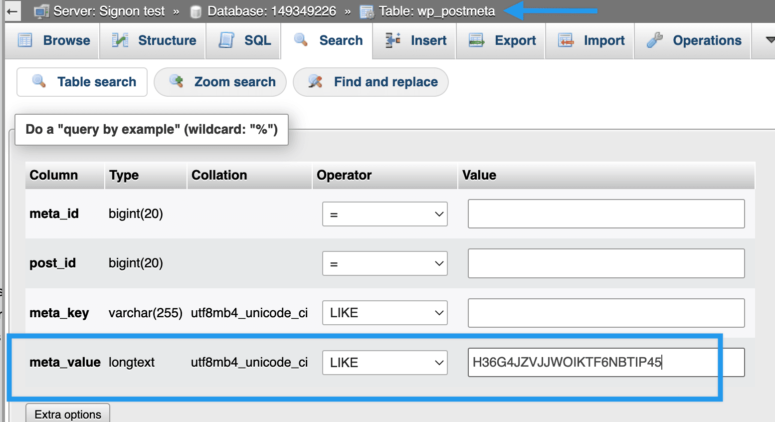

    Hey @raheemmurtaza,
    What that error means is WooCommerce and Square are attempting to sync an item with the Square ID H36G4JZVJJWOIKTF6NBTIP45. However, this ID doesn’t exist on the Square side so it’s returning an error.
    We have an open bug report about this with the developers to get a fix made. Until that happens you may be able to fix it this way.
    Back in your database, go to the _postmeta table and search the meta_value for H36G4JZVJJWOIKTF6NBTIP45.
    The post_id that is returned here will be the ID of this product. Take that ID number and search the _postmeta table for this post_id number. Then remove all of the rows that start with _square.
    **Please make a backup before making any changes.**
    After that you should be able to sync the product to Square again. You may have to toggle syncing off, update the product, and then turn it back on again.
    Let us know how that goes.
