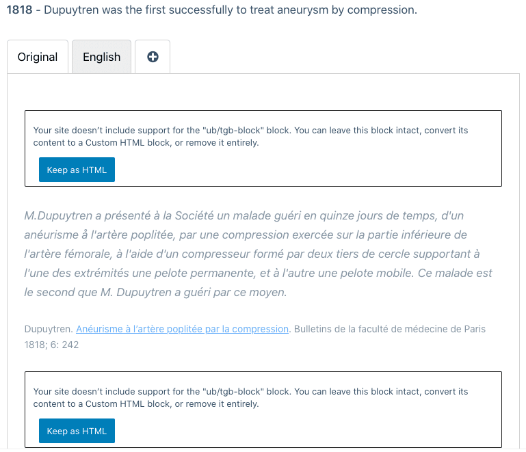

    Hi team. Love the plugin, was working well until an error today. All plugfins up to date and using the latest version of WP.
    Not sure how to fix. I use the tabbed content to create translations in posts and pages and all were working well until today. Now none of the tabbed content appears on the public page and the message in the editor reads:
    Your site doesn’t support “ub-tgb-block” block.
    Any assistance greatly appreciated before going back and re-writing 200 posts…

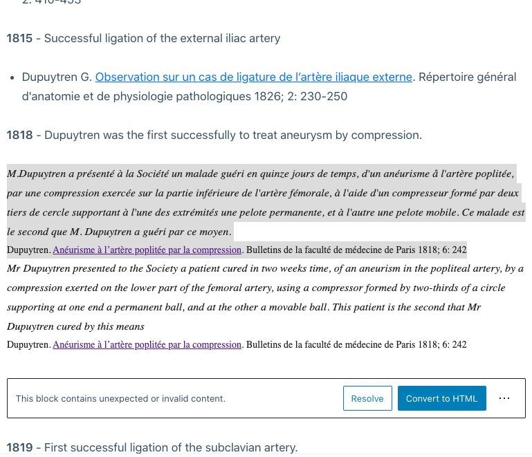

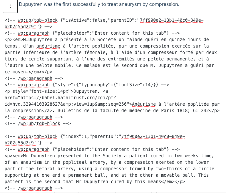

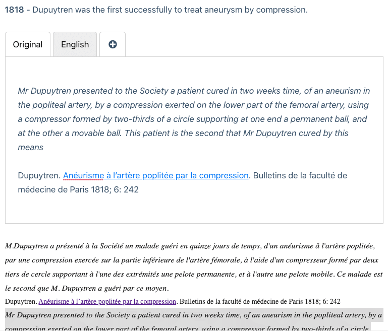

    Solution for each posts seems to be to open as html, copy the html, retrieve the content and rebuild each tabbed block again. Time consuming, but seems to work. Not sure why all the tabbed content has suddenly decided it needs to be re-written…
    Here are screenshots fo the steps I am taking on each post:
    Tabbed content 1
    Tabbed content 2
    Tabbed content 3
    Tabbed content 4

    Hi @sandnsurf! Thanks for letting us know. Upon further inspection, it seems that something went wrong with your copy of the plugin. We don’t have a “ub/tgb-block” block. However, if the tabbed content block is being read correctly, you should instead see “ub/tab-block” when viewing the page in the code editor. Have you tried reinstalling the plugin from a freshly-downloaded copy?

    Have uninstalled and installed fresh version from WP and from website
    Unfortunately the ub/tgb-block persists in all the old posts, but when i manually edit and replace the ub/tab-block is added and persists
    Not sure what happened or if there is an easier fix, but for now will just rebuild the old posts. Thank you
