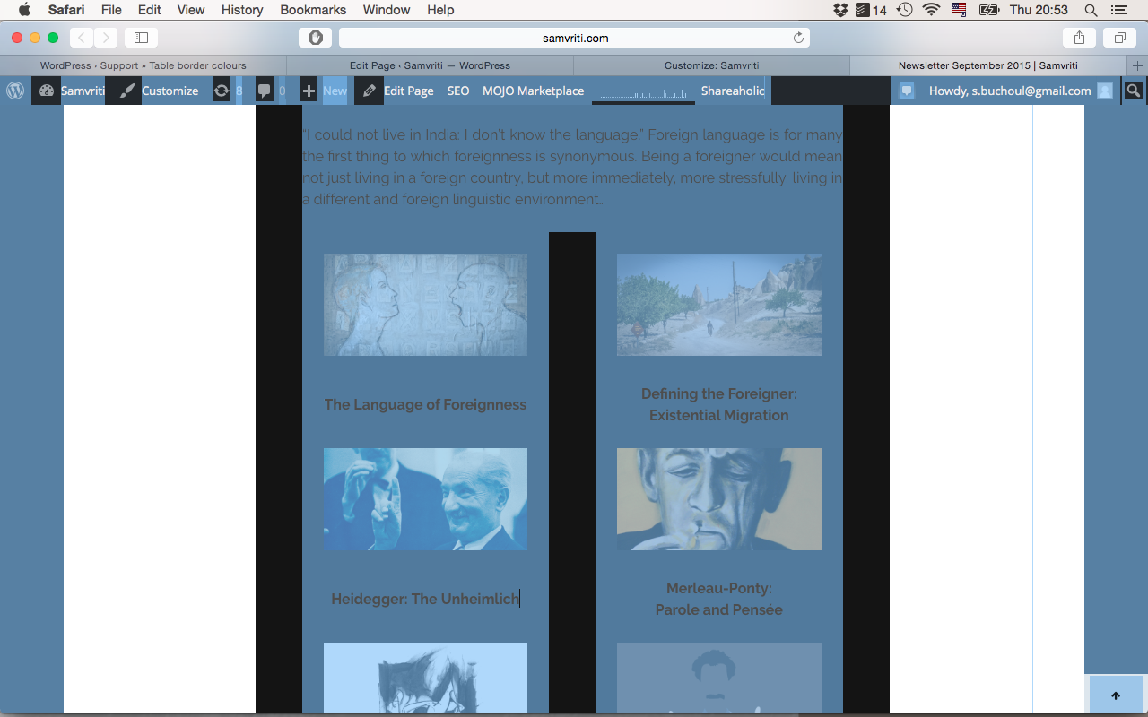

    Thread Starter samtazbu
    (@samtazbu)
    Hello Ben,
    I tried but it is not working… See the following link for a screen shot of my page, once everything is selected and the table zones are visible: http://www.samvriti.com/wp-content/uploads/2015/09/Screen-Shot-2015-10-01-at-8.53.09-pm.png
    Something blocks each image from taking the whole width of each cell, while the size set to each image and the width set for the corresponding cell are the same…
    Thanks,
    Samuel
    Theme Author Ben Sibley
    (@bensibley)
    Okay the previous code removes a small amount of padding around the images, but they also have a margin applied. This code will remove the margin around the images.
    .entry-content table img {
      margin: 0 !important;
    Once that is applied, they will display at the exact size set for them. If you want them to fill the table cell regardless of the size set in the HTML, you can add the following as well:
      width: 100% !important;
      max-width: none !important;
    This is how it should look with all of the above code applied: http://pics.competethemes.com/image/1o0H1s3J3K3V
    This is how it will look if the previous padding CSS is applied too: http://pics.competethemes.com/image/043s3w3a3Y45
