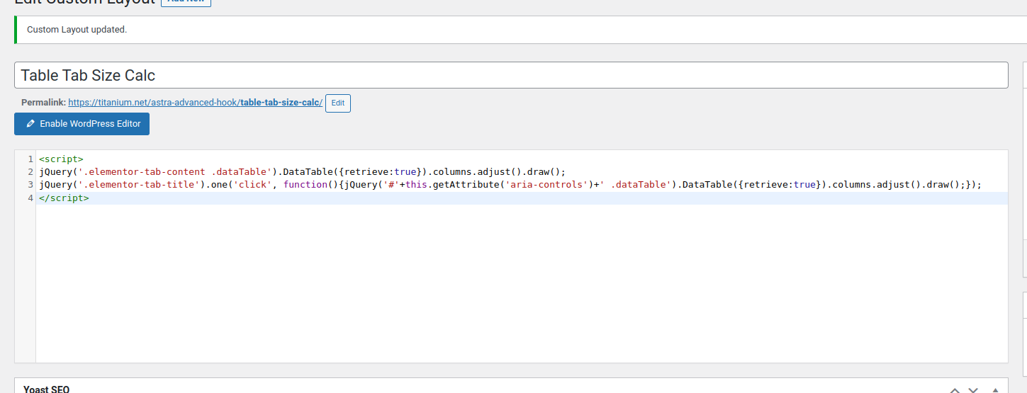

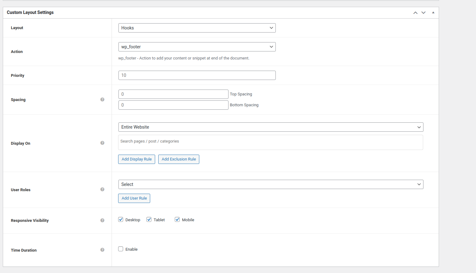

    I’m using Astra Pro which has a “Custom Layout” feature. I’ve gone through the docs on how to use it, it does seems to be inserting the code which you kindly shared, although doesnt seem to be firing / updating the table still. I’m not sure why…

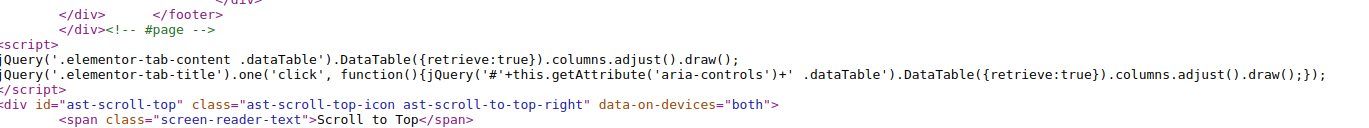

    The code is inserted into the page line 3291.
    view-source:https://titanium.net/flange/
    Do you have any thoughts on what I might be missing ?

    that looks promising! Can you please try again with
    jQuery(function($){
      $('.elementor-tab-content .dataTable').DataTable({retrieve:true}).columns.adjust().draw();
      $('.elementor-tab-title').one('click', function(){$('#'+this.getAttribute('aria-controls')+' .dataTable').DataTable({retrieve:true}).columns.adjust().draw();});
    and change “Priority” in those settings from 10 to 11? This should move this code below the TablePress code (it’s need to run after that).

    Thanks alot to keep looking into this, really appreciated! I tried the updated code also set priority to 100 to force it to go right at the bottom after the tablepress JQuery script. Ah still no joy unfortunately.
