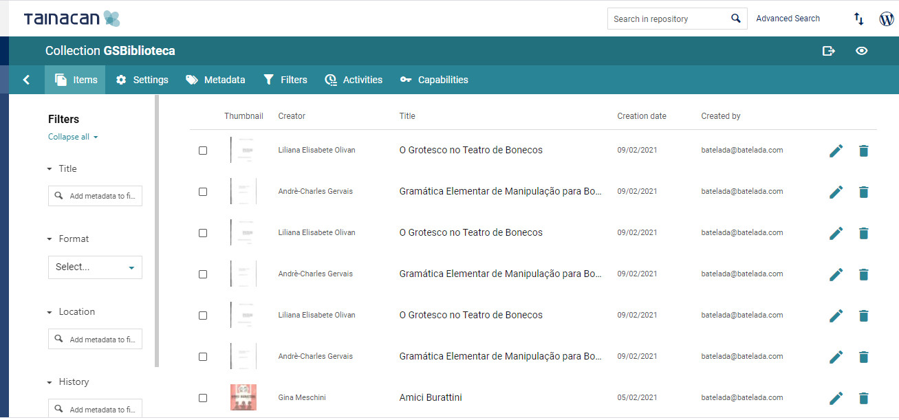

    Anyway, the problem is not in the csv file. Each time I delete the uploaded items, I can upload 2 new items (the next goes, again, to the draft folder and the process is repeated). The duplicated images and the duplicated copies of the csv files are stored in the media library. In a fraction of a second the 1st items are upload, then in a slow loop the uploading is repeated… I disabled the wp-cron manually and then I installed a plugin named WP Crontrol disabling “running wp-cron”, changing Tainacan recurrences to “once hourly” and apparently nothing changed.
    I am uploading here an image of the image duplication until I abort the upload process, just in case:
    http://batelada.com/tainacan-issues/tainacan1a.jpg
    http://batelada.com/tainacan-issues/tainacan1b.jpg
    http://batelada.com/tainacan-issues/tainacan1c1.jpg
    http://batelada.com/tainacan-issues/tainacan1c2.jpg
    Thanks for the support and kindness!!!

    Inserting item 1
    item with ID 50 not found. Unable to update. Creating a new one.
    Document file URL imported from http://biblio.batelada.com/I_Semana_de_Estudos_sobre_o_Teatro_de_Anima__o_0.jpg
    Setting item thumbnail: 33260
    New Request
    Starting processing new item
    2021-02-12 21:36:52
    User in process: 1
    Processing item 0
    Processing item on line 2
    Target collection: 22831
    Success processing index: 0
    Inserting item 0
    item with ID 49 not found. Unable to update. Creating a new one.
    Document file URL imported from http://biblio.batelada.com/A_Dan_a_e_a_Forma__o_Corporal_do_Ator-Manipulador_0.jpg
    Setting item thumbnail: 33271
    2021-02-12 21:36:53
    User in process: 1
    Processing item 1
    Processing item on line 3
    Success processing index: 1
    Inserting item 1
    Setting item thumbnail: 33295
    Ainda não sei como agradecer tanto suporte e tanta atenção ao problema que venho enfrentando… Mas estou imensamente agradecido.
    Plugin Author vnmedeiros
    (@vnmedeiros)
    Boa tarde @batelada,
    fizemos algumas atualizações no plugin que devem ajudar a entender melhor como resolver esse erro, se possível pode atualizar e fazer o seguinte:
    • atualizar o Tainacan para a versão 0.17.4
    • limpar todos os transient do seu banco, isso vai forçar ele atualizar o cache do WP (pode ser a causa do erro “out of sync”), SQL para fazer isso:
      DELETE FROM wp_options WHERE option_name LIKE ('%\_transient\_%');
    • ativar os logs da importação adicionado no wp-config.php:
      define('TAINACAN_DEBUG_BG_PROCESS', true);
      define('WP_DEBUG', true);
    • Fazer uma importação de um CSV simples e verificar os Logs gerados
    • * Recomendo desativar outros plugins que estejam ativos, pelo log enviado parece que existem outras atividades de outros plugins causando o erro “out of sync”.
    • This reply was modified 5 years, 3 months ago by vnmedeiros.
    Thread Starter batelada
    (@batelada)
    Segui todas as recomendações e consegui fazer o upload de um maior número de itens… de 12 a 15 (antes o upload era de 2 itens), antes que o ciclo recomeçasse, com um item cau=indo na pasta draft e novo ciclo se iniciando. Marco como “ignore”, não como “update” in “repeated items options”
    Aumentarei o max_execution_time, manualente, no ht_acesss para 300. Identifiquei que o tainacan reconhecia o max_execution_time como 120… o que não parece ser ruim… parecia modificado para 300 na alteração que fiz pelo hpanel, mas o Tainacan ainda identificava como 120… n acho que seja isso mas acrescentarei uma linha ao ht_access, em todo caso, e farei novo teste.
    O log, agora… (até eu interromper o processo)
