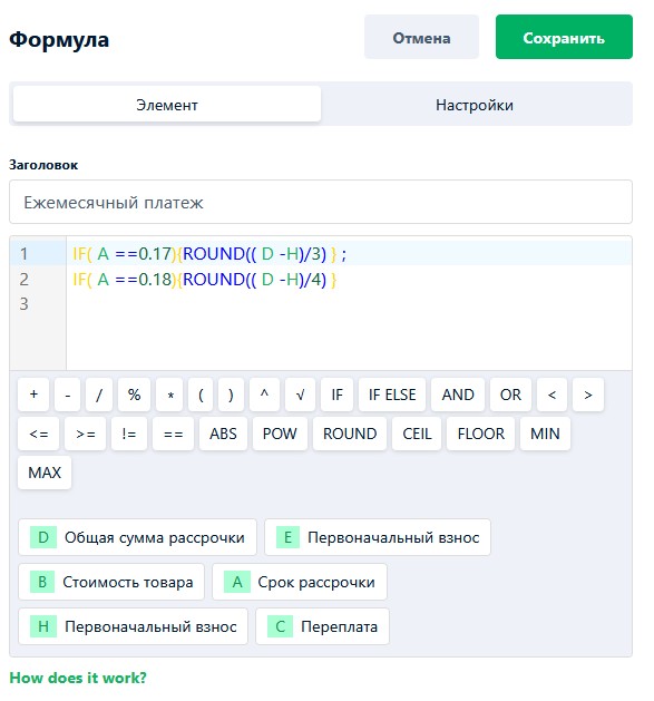

    The issue is caused by an incorrect formula setup. When using multiple if statements, you should use IF followed by ELSE IF for the subsequent conditions, without using semicolons. Here’s how you should structure it – please see this screenshot for reference: https://share.zight.com/yAuRQKrR
    Here is the corrected version of your formula:
    IF(A == 0.17) { ROUND((D - H) / 3) }
    ELSE IF(A == 0.18) { ROUND((D - H) / 4) }
    Keep in mind that incorrectly written formulas may still work in Firefox due to differences in how browsers interpret JavaScript, but the formula should follow proper syntax to ensure consistent behavior across all browsers.
