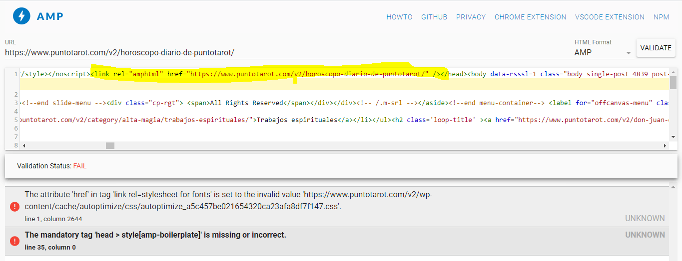

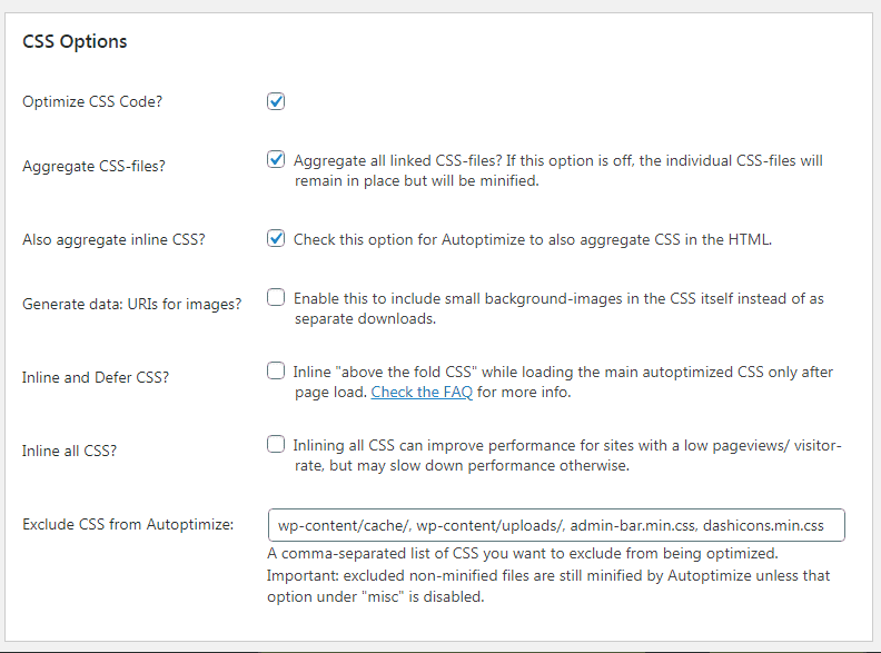

We checked your issue. There is no problem with AMP takeover. You have to get those errors is AMP validating errors. That is due to the use of Autoptimize plugin. It minifies the CSS. Can you please share a screenshot of the Autoptimize settings page? After we will check it and help you to fix this problem.
hey Ahmed; AO should not trigger on AMP-pages at all, see https://github.com/futtta/autoptimize/blob/beta/classes/autoptimizeMain.php#L421-L431 any idea why that would not trigger?

I send you the screenshot of
Autoptimize setting page
The link <link rel = “amphtml” href = “https://www.puntotarot.com/v2/horoscopo-diario-de-puntotarot/” /> appears on the original page
when should it be
<link rel = “amphtml” href = “https://www.puntotarot.com/v2/horoscopo-diario-de-puntotarot/amp” />
screenshot page original link rel

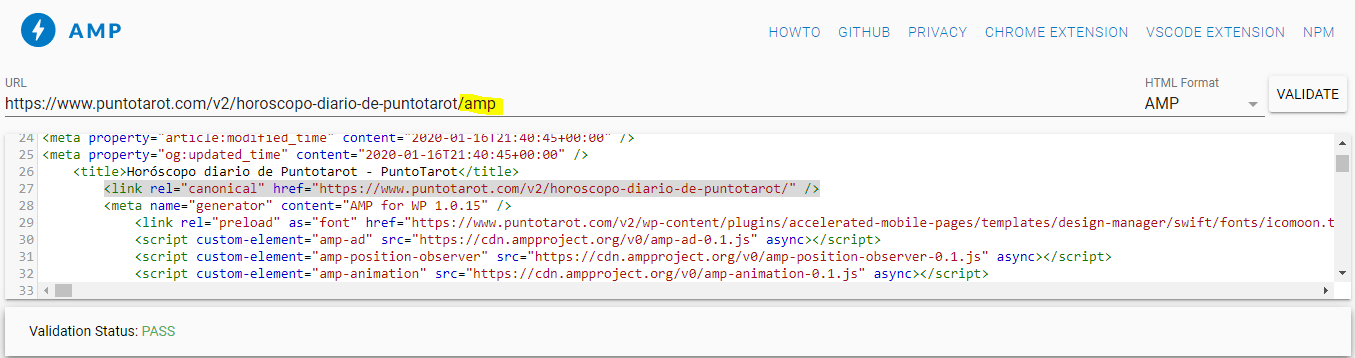

while the amp page is correct!
screenshot page amp

We checked your issue. The amp HTML is working perfectly on your Non-AMP page.
Reference: https://monosnap.com/file/HgM915tWSuvNAs8dOpbR0WmxtVgrmY
Can you [please tell me are you do any changes on your page?
