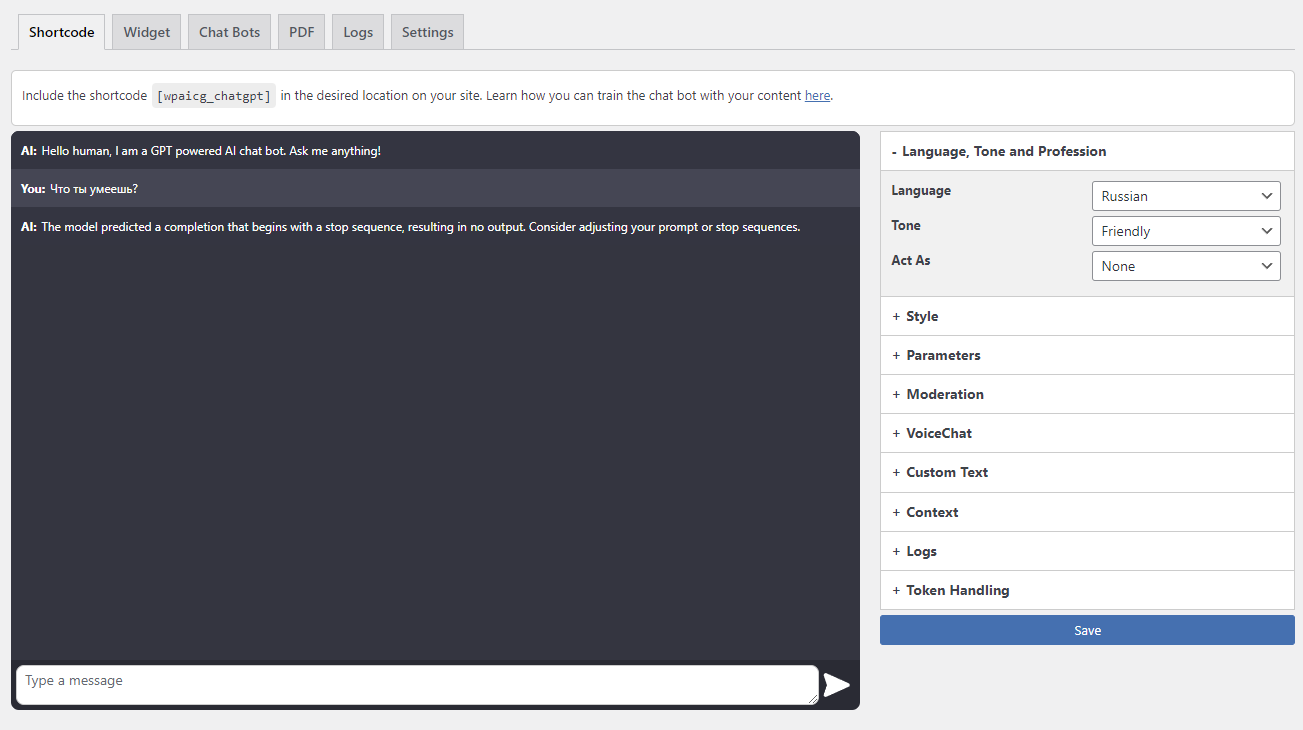

• I am trying to use ChatGPT mode and no matter what I write in chat, I get the following message: “The model predicted a completion that begins with a stop sequence, resulting in no output. Consider adjusting your prompt or stop sequences.” ( https://c2n.me/4jLPUgO.png )
    I have tried changing AI models and bot parameters, but to no avail.
    What am I doing wrong?

    Could you please share with me your ai parameters and also Context tab settings?
    Hello! I also started having this problem two days ago. What does this have to do with not only your plugin, but also other plugins for integration with OpenAi. I noticed that if the site is on Russian hosting, then there is no output from OpenAi at all, or the message “The model predicted completion…” is displayed. And even if, for example, you specify the wrong API key, then instead of the displayed error “incorrect API key”, the result displays “The model predicted completion…” or is empty.
    But if you install the site along with the plugin on a hosting that is not in Russia, then everything works fine. This problem suddenly appeared two days ago. The OpenAi account is paid and there are no restrictions for Russia.
    Maybe you know what the problem might be?

    @insellup, thank you so much for this information. It is very valuable as I was trying to understand what is going on.
    Is it possible that OpenAI has stopped responding to API calls from Russia?
    I just came across a forum post where people are saying the same thing. They are probably related, and it seems like there might be a restriction from OpenAI now?
    https://platform.openai.com/docs/supported-countries
    https://community.openai.com/t/api-access-failed-showing-cloudflare-block-page/506015/1
    • This reply was modified 2 years, 6 months ago by senols.
    @senols, thanks for the links to the forum, I see that the problem is not only for Russia!
    Russia is not included in the list of supported countries only for a free OpenAi account. If the account is paid, then until this moment there were no problems with connection in Russia. Most likely, OpenAi’s policy has now changed or they simply have some technical glitches for some countries.
    I’ve been working with your plugin for several months now and it’s really a very good plugin! Now I had to move the site to hosting in Europe so that the plugin would continue to work.

    Just curious if OpenAI changed their policy because of this maybe?
    https://decrypt.co/205446/chatgpt-outage-openai-ddos-attack-russian-hackers
    @senols, indeed, it is most likely because of this. Because the API for Russia was disabled approximately after that :-(. I hope there will be no more such attacks and it will be possible to use it from Russia again.

    Thread Starter alexschneider_ru
    (@alexschneider_ru)
    Same problem with the other similar plugin. Same website/hosting), so probably Russian hosting is the reason: https://ww.wp.xz.cn/support/topic/php-error-in-chatbot/
