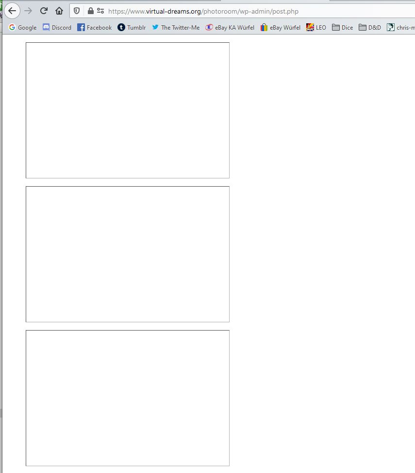

    2) I click on the “Publish” button on the right. It takes forever to load, then it displays a white page with a bunch of white images (like a gallery page that’s broken). Example here: https://www.virtual-dreams.org/stuff/FooGallery5.JPG (URL is …/wp-admin/post.php).

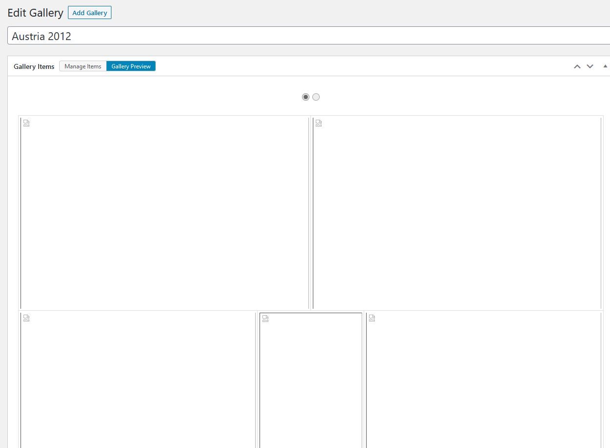

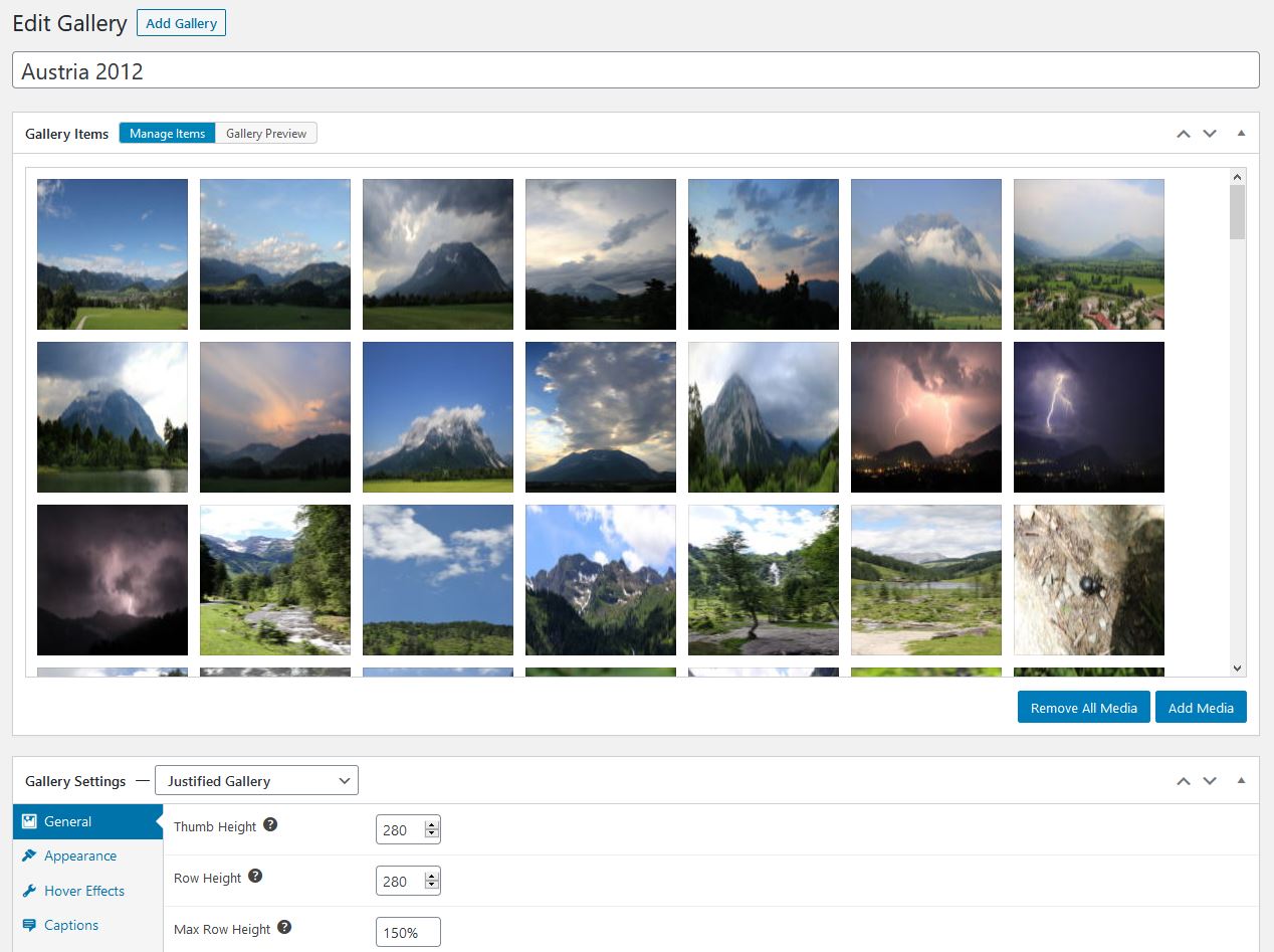

    3) When I go back to the gallery page (which often takes forever to bring up) and click on “Gallery Preview”, most thumbnails are broken and don’t show up, while others do. Example here: https://www.virtual-dreams.org/stuff/FooGallery1.JPG The “Manage Items” list looks fine: https://www.virtual-dreams.org/stuff/FooGallery2.JPG

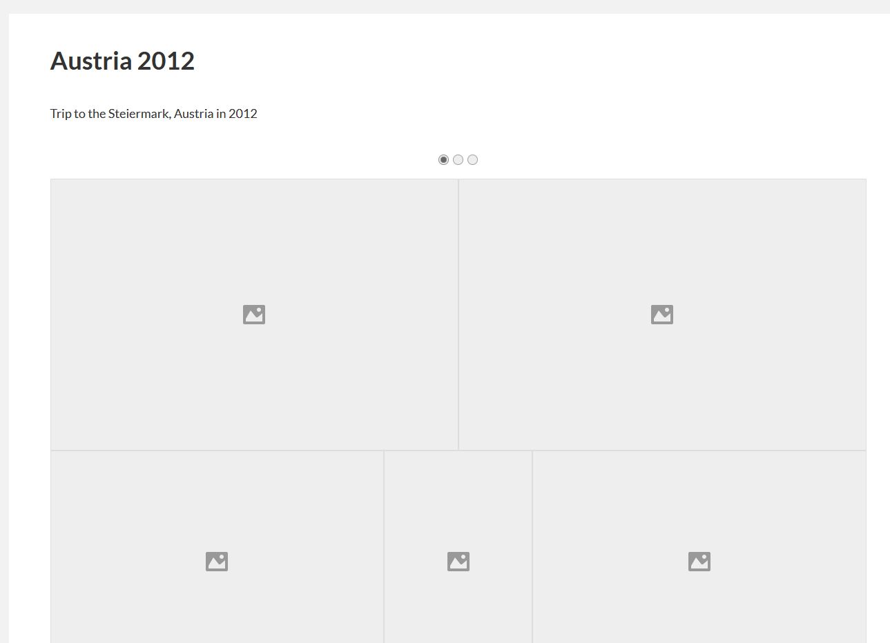

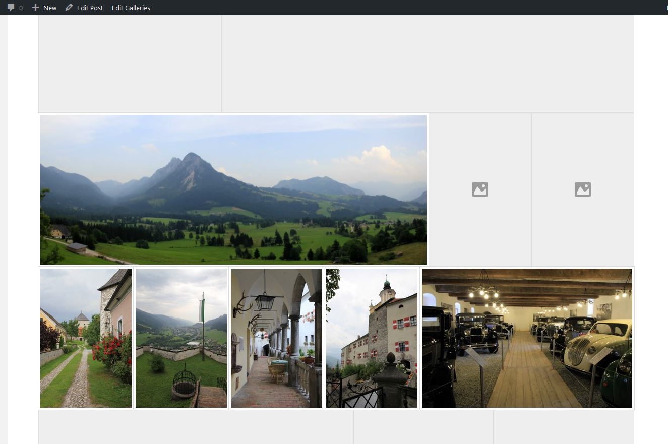

    4) When I go to the post I created that has the gallery in it, it shows mostly broken thumbnails with placeholder images. Examples here: https://www.virtual-dreams.org/stuff/FooGallery4.JPG and https://www.virtual-dreams.org/stuff/FooGallery6.JPG

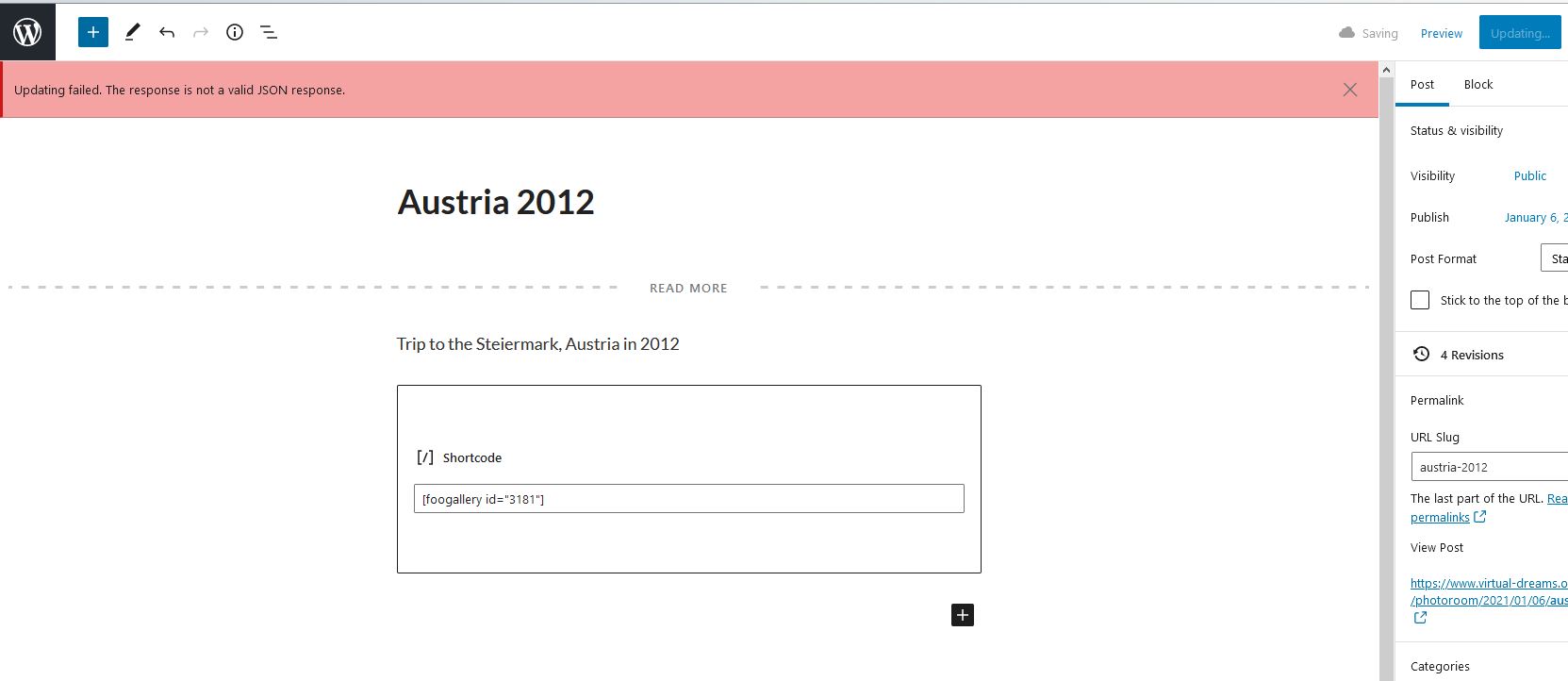

    5) Sometimes when I create or make updates to a post that has a FooGallery in it, I get an error “Updating failed: The response is not a valid JSON response.” Example: https://www.virtual-dreams.org/stuff/FooGallery3.JPG

    The JSON error still appears for me in the WordPress post, though. Anything that can be done about that?
    Plugin Author bradvin
    (@bradvin)
    You’ll have to check what the WordPress save call is actually returning. To do this, you’ll have to view the actual call response in your browser’s developer tools.
    For Chrome:
    Right click anywhere on the page, then select “Inspect” or “Inspect Element” to bring up the browser’s developer tools.
    Navigate to the “Network” tab of the developer tools
    Click on “XHR” in order to view only ajax calls
    Once you’re there, save your page in WordPress admin, then check the last of the newly added entries in the network tab.
    Check the “Headers” tab of the new entry and you should see “/wp-json/…” in the “Request URL” to indicate that it’s a rest API call.
    Check the “Response” tab, the contents of that may give a clue on what’s happening.
