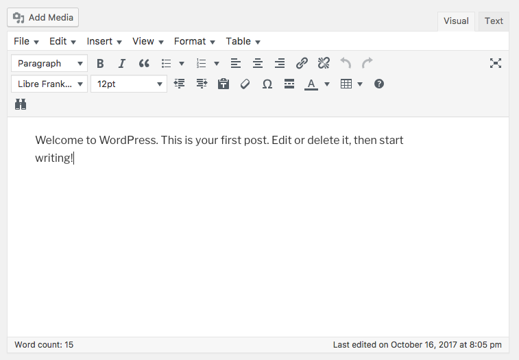

    I installed the TinyMCE Advanced plugin that the customer mentioned in the forum, but it is still not obvious to me what are the missing features that our implementation of the editor has:
    Edit Post (standard admin screen):
    https://user-images.githubusercontent.com/45068/34397696-548475aa-eb46-11e7-9cc3-48b473b12d12.png

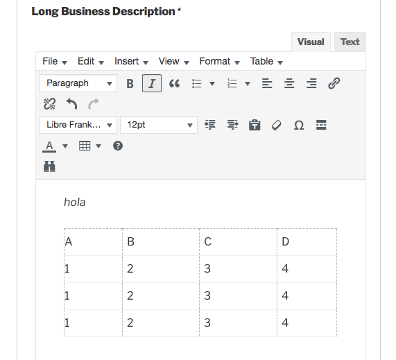

    Submit Listing:
    https://user-images.githubusercontent.com/45068/34397702-5feb6aa2-eb46-11e7-9c68-d3ac8be2c50d.png
    There are still CSS/layout issues, but I see all the menu options.
    We need to know more about the customer’s specific problem (see #3337 (comment)) so that we can try to create a solution that works on his website and in the other scenarios we need to support.
