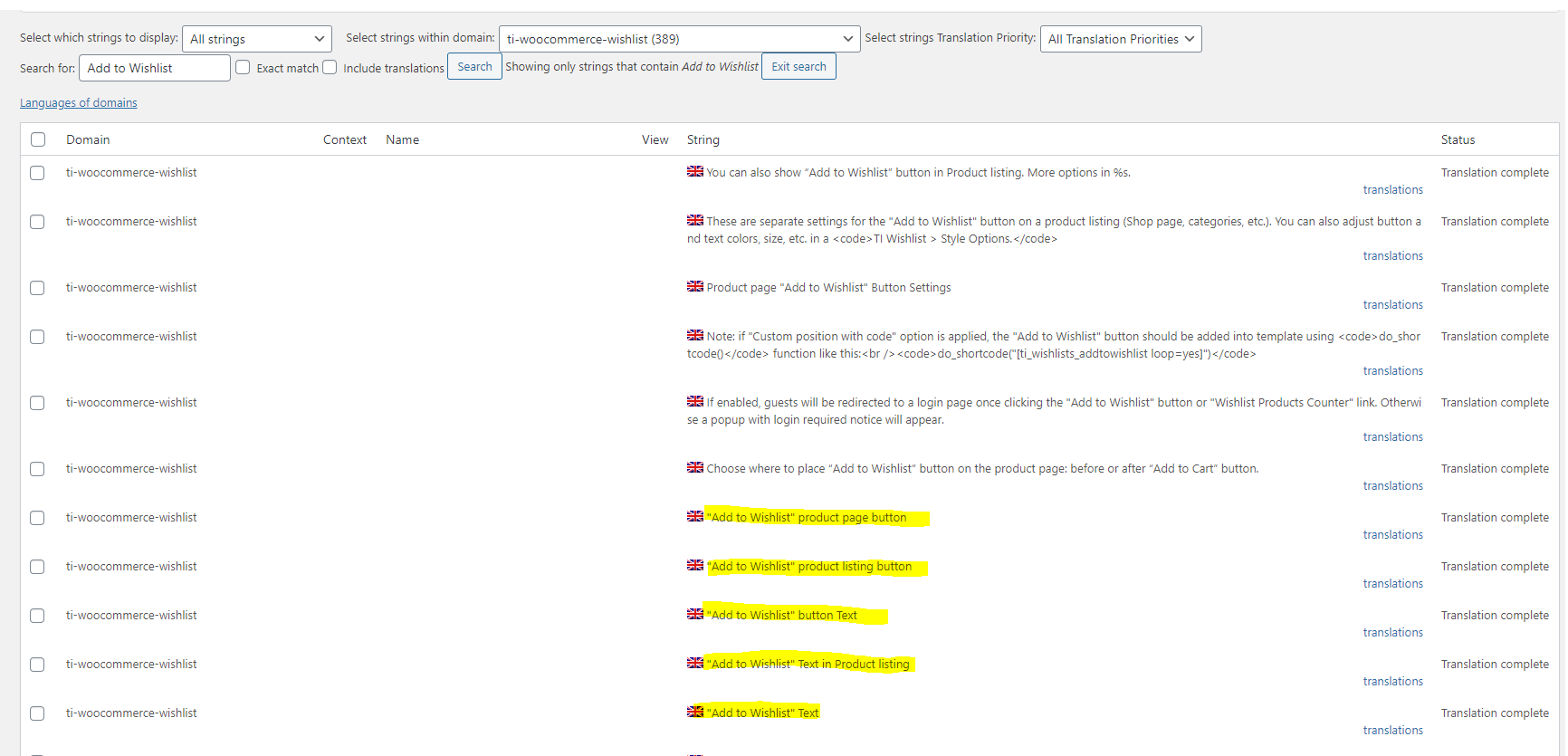

    To translate the plugin buttons texts with WPML I went to WPML’s “String Translation”.
    Let’s say for example I wish to translate this text: “Add to Wishlist”.
    I search for it in string translations, and then I translated all the ones I marked in yellow: https://i.gyazo.com/b4db266aa88b897802c767a44889750b.png
    I checked the option “Use my translation”. But this does not work

    You have translated the wrong strings.
    Set the “In domain” filter to “All domains” since the mentioned text is a settings value and not a regular domain string.
    You will see two strings with domains “admin_texts_tinvwl-add_to_wishlist” and “admin_texts_tinvwl-add_to_wishlist_catalog”

    Those seem to be the correct translations, it’s working now. Thanks for pointing this out.
