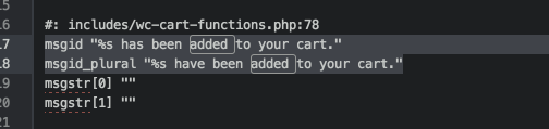

    Are you sure the po is up to date then?
    The string differs:
    https://dl.dropboxusercontent.com/s/k0sm7lrid2z2eic/2015-08-20%20at%2013.30.png?dl=0
