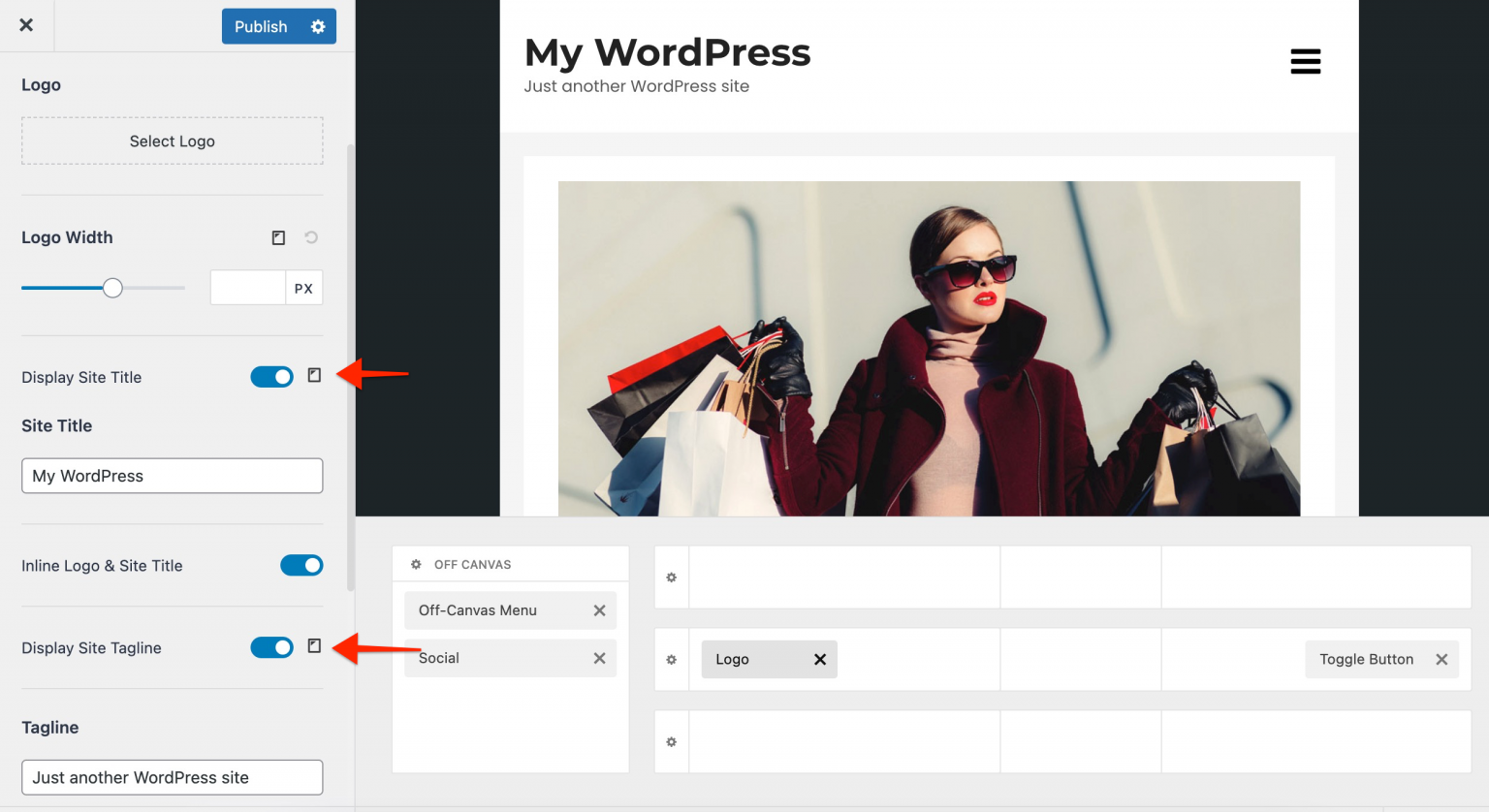

    Just in case you are not aware, we added a new option Display Site Title on responsive mode since v.3.5.0-Beta.1. Refer to this screenshot, please. So, we don’t need any custom CSS to hide the Site Title on mobile.

    Anyway, since Astra v3.5.0-beta.1, there’s an option to show/hide the Site Title and Site Tagline, so it’s not necessary to use custom CSS to hide it on mobile. Please refer to this screenshot.
