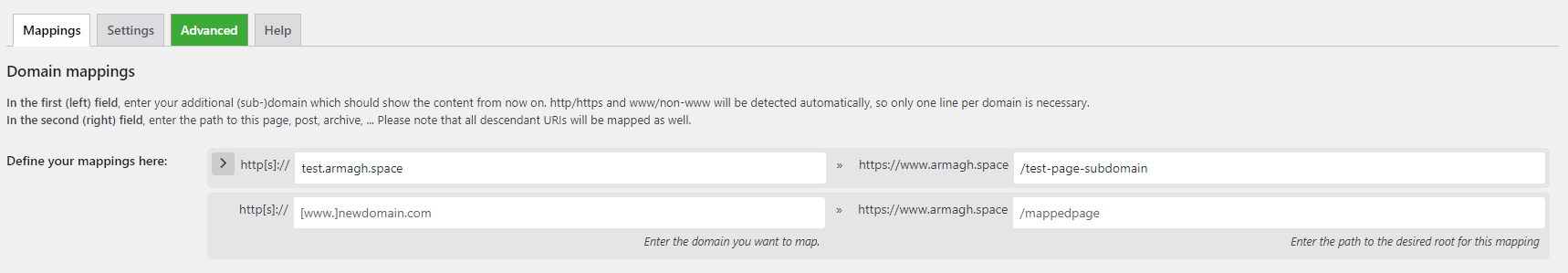

    I then put the mapping back in to your plugin. Now when you go to test.armagh.space, it redirects to https://test.armagh.space/test-page-subdomain which is just a 404 page.
    I need that when you go to test.armagh.space it just displays the https://www.armagh.space/test-page-subdomain page but keeps the test.armagh.space url in the address bar.
    Have I perhaps set up your plugin incorrectly? Please see screenshot below.

    Plugin Author matthias.wagner
    (@matthiaswagner)
    hy,
    glad to hear that setup worked.
    sometimes wordpress automatic redirections cause such stuff. could you try to rename the url slug of your test page to something like “try-page-subdomain” so that “test” does not occur?
