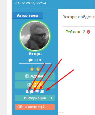

    Hi @realstash
    To do this you just have to add this code to your themes functions.php file:
    add_action('asgarosforum_after_post_author', 'my_function_asgaros_cabinet', 10, 1);
    function my_function_asgaros_cabinet($author_id) {
    	echo '......';
