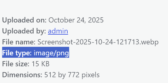

    Whats only needed settings to be turned on in Phoenix Media Rename Settings for this plugin to work, i want to disable unnecessary ones. I also see the after conversion to webp format filetype doesn’t change to webp. Thank you

    Please could you send a screenshot of where you are seeing the incomplete filetype conversion to [email protected]

    @richard-b Conversion is successfull, just file type is not getting updated.

    @thetailoredhealth Thank you so much that is really helpful, also thank you for alerting us to this issue, will let you know as soon as it is resolved.

    @thetailoredhealth Thank you for your patience, we have just released a fix for the issue you mentioned.
    Also if you visit the settings page (Settings > Media) you will see an update utility to correct any previously converted media to the correct MIME type.
    We are really grateful you raised this issue as it was only happening on some server setups, if you would like to reach out to us on our support email address above we would like to offer you a bug bounty as a way of showing our appreciation.
