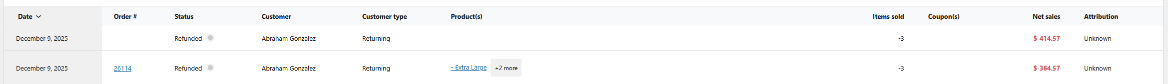

    I recently transferred my website to a new website that I had redesigned. However, my WooCommerce reports and Analytics are a complete mess, and I need to get it fixed before tax time, and Woo just stopped responding to my tickets. They told me to just use Analytics as reports are not supported any longer. But both are busted, and I don’t know what to do. It’s not recording refunds properly. When I imported my data, it took all 5 years of refunds and put them into last month. So it’s showing I had a loss of $17,333.34, even though I can see what orders were refunded and when. Reports does not see it that way and only links to 4 times, drastically causing issues come tax time. Now, as I only had a few refunds this year, I was going to try and work it out on paper for taxes and just focus on using Analytics. But I had a refund the other day, and it made a ghost refund, thus doubling my refund.
    Furthermore, it was a partial refund, and I ran it through the system, clicked refund, and selected the quantity for each of the items. However, this was a custom-made product, so there was a restocking fee. So I just deducted that on the item’s price. It did give the customer the right amount, but it flagged it in the system at the whole amount and then made a ghost refund. So for this month it’s showing -$826.64 when it should be showing -$388.32, and I’m at a loss. I can’t keep running this site this way and have been thinking about abandoning WP/Woo altogether and just going to Shopify or something. But this is the last thing I want, but this system is FOOKED, and I’m at a loss at trying to fix it. Even more, someone with Woo stopped replying.

    Also, I noticed two refund entries for A. Gonz… on December 9 on the screenshot; one with no order number and one tied to order #26114. Do you recall if both were triggered from the same refund action, or was one manually added?
