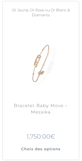

    here is the website
    I already put the code of bridge directly to functions.php
    i also think that change priority can work because on the inspector console, when i drop the line of the subtitle under the product title, it is exactly what i want but i don’t know how to do it in wordpress.

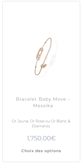

    Hello, as you were thinking, it was the name of the hook who needed to be replaced.
    add_action( 'ocean_after_archive_product_title', 'kia_add_subtitle_to_loop_product', 20 );
    Thanks for your help!
