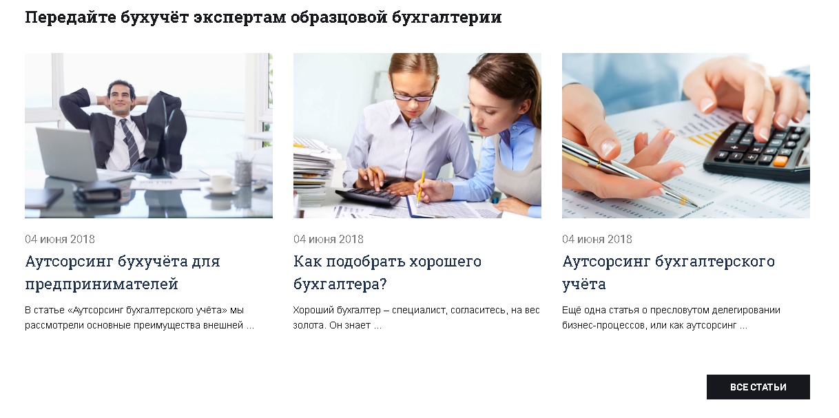

Hello, thank you for usefull plugin.
I have a problem, and i cant find any solution.
From time to time my wpp widget is stop showing any posts, but in the admin panel view counts is ok. Then i open any post and it appears in front page widget.
I dont have any errors and ideas why they are disappearing.
Sorry if i ask a similar question.Screenshot of widget:

Hi @hangook,
Don’t worry about your english, it’s fine as it is.
Just checked your site and the widget seems to be loading normally. Because of that, it’s difficult to say what’s going on.
When it happens again:
- Take a screenshot of your home page.
- Take a screenshot of your browser’s console while browsing the home page.
- Take a screenshot of your home page’s HTML source, specially the one related to the widget.
- Check your server’s error log and look for warning/error messages that may be related to the plugin.
