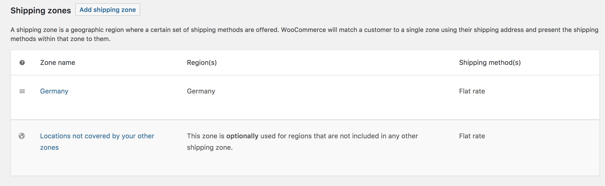

    When I set up my Shipping so that I have two zones – one for Germany at 3.50, and one for anyplace not covered by that zone for 9.50 – then click on the PayPal express button on the product page, the correct shipping (9.50) is shown for me (my PayPal account is not in Germany). Here are some screenshots:
    This just shows you that I have two zones https://cldup.com/eUCulY0DHF.png
    The first is a flat rate of 3.50 for any German address, and the second is anywhere not Germany, with a flat rate of 9.50.

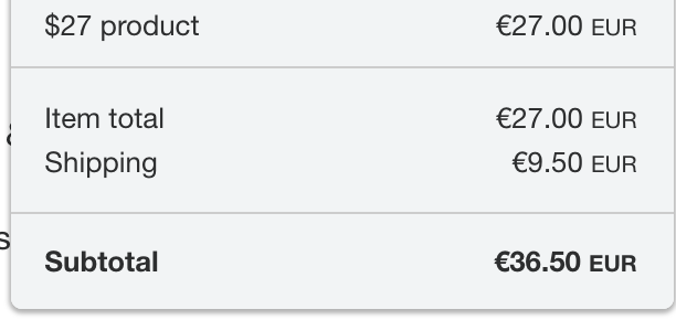

    This screenshot is from inside PayPal, once I have clicked the Check Out With PayPal button in the product page itself (not the checkout page) – it shows me the breakdown of price: https://cldup.com/f1wzyfYsbW.png
    As you can see, PayPal is drawing from my already established location that I am not in Germany. When I change the shipping destination to another location, within Germany, I do not see the price update, however, to reflect the lower price. It remains the same. We’ll have to continue to dig to see if this is something that can be changed, however.
