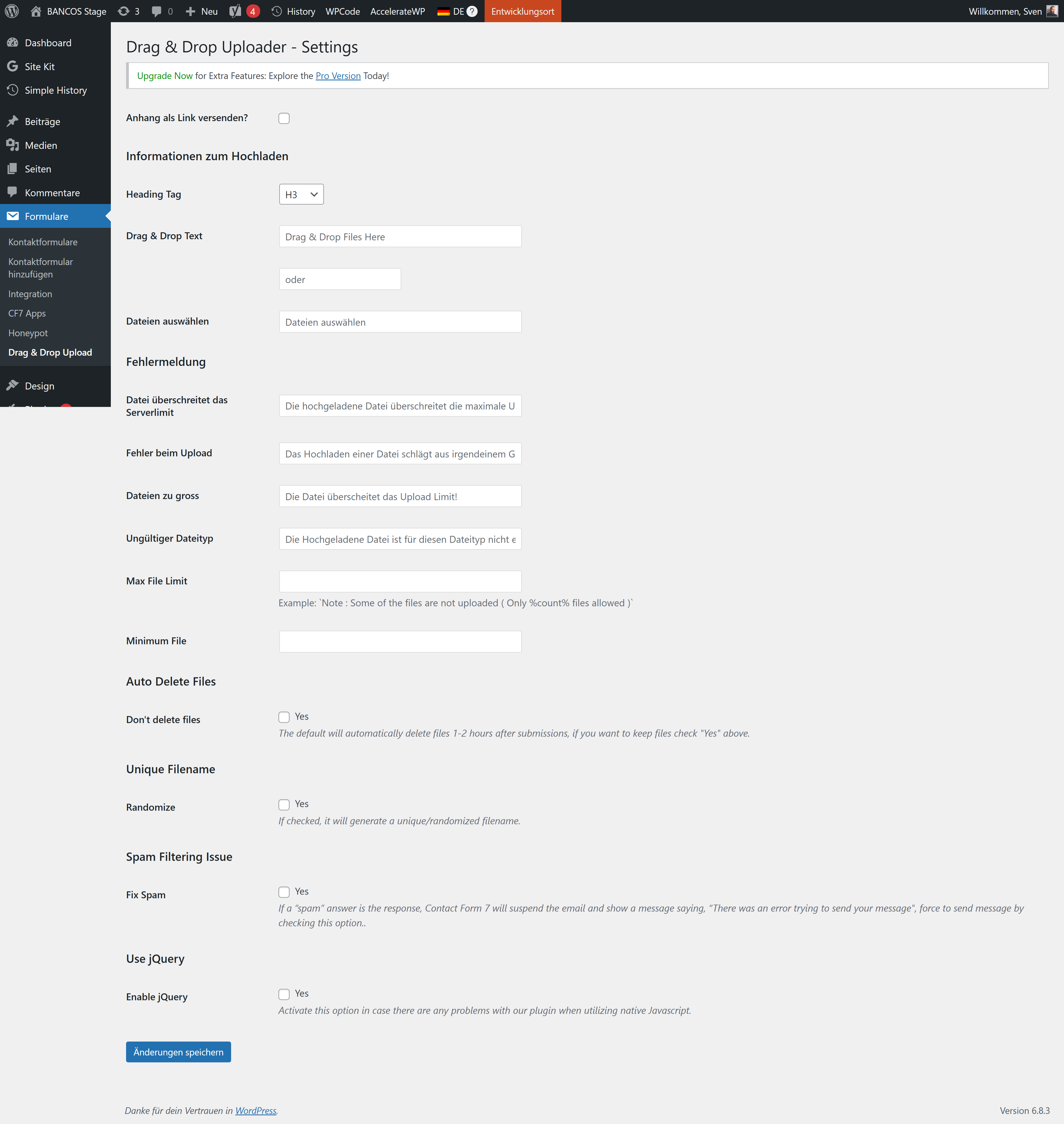

    Thanks for your quick answer. Can you tell me in which path the dot is?
    https://advanced-simple.de/drag-and-drop-uploader-settings.png
    The settings and site info are from the staging site, but the error appears there too.
